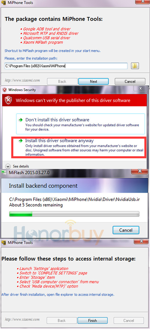

1. First of all download all the things you need.
A. ADB/Fastboot driver
B. MiFlash Tool
and install these to your PC!

Thank you for this full info
when I try to install MiFlash to the PC its chow me like this
