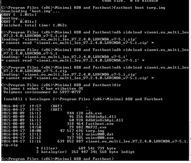

Looks like you are getting file names in the console wrong again. In this case, you are requesting your computer to sideload the file without providing the correct file name.Therefore the system can't fnd the file and thinks it doesn't exist.
Make sure files you are trying to load exist in the ADB/Fastboot directory and you are typing their full and correct names. In this case, type:
adb sideload xiaomi.eu_multi_leo_V7.2.4.0.LXHCNDA_v7-5.1.zip
i tried again with new name no success for me
Dude, for some reason your file is named xiaomi.eu_multi_leo_V7.2.4.0.LXHCNDA_v7-5.1.zip.zip
http://shot.qip.ru/00KSN6-1eLukldHv/
You need to provide the exact name of the file (with extension) to the fastboot sideload utility exactly the way it is named in your file system.
try running:
adb sideload xiaomi.eu_multi_leo_V7.2.4.0.LXHCNDA_v7-5.1.zip.zip
If this does not help or you have difficulties using long file names in the console, do this:
1. Go to Windows File Explorer
2. Go to C:\Program Files(x86)\Minimal Adb and Fastboot directory
3. Rename the file xiaomi.eu_multi_leo_V7.2.4.0.LXHCNDA_v7-5.1.zip.zip file into something simple, like xiaomi.zip
4. Get back to the console and run adb sideload xiaomi.zip
Hope this helps.

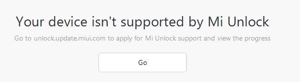

Getting this error:
FAILED (remote: unlock device to use this command)
any advice?
thank you
You have to unlock your device. Follow Q17 of this guide or apply for an unlocking code via miui unlock.

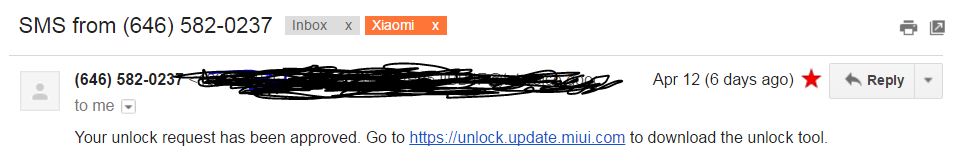

Really appreciate your help. Weird thing is, I did apply and received this email (attached). So why isn't it unlocked?
I guess, something went wrong (judging by your second screen shot) and your device did not get unlocked.
