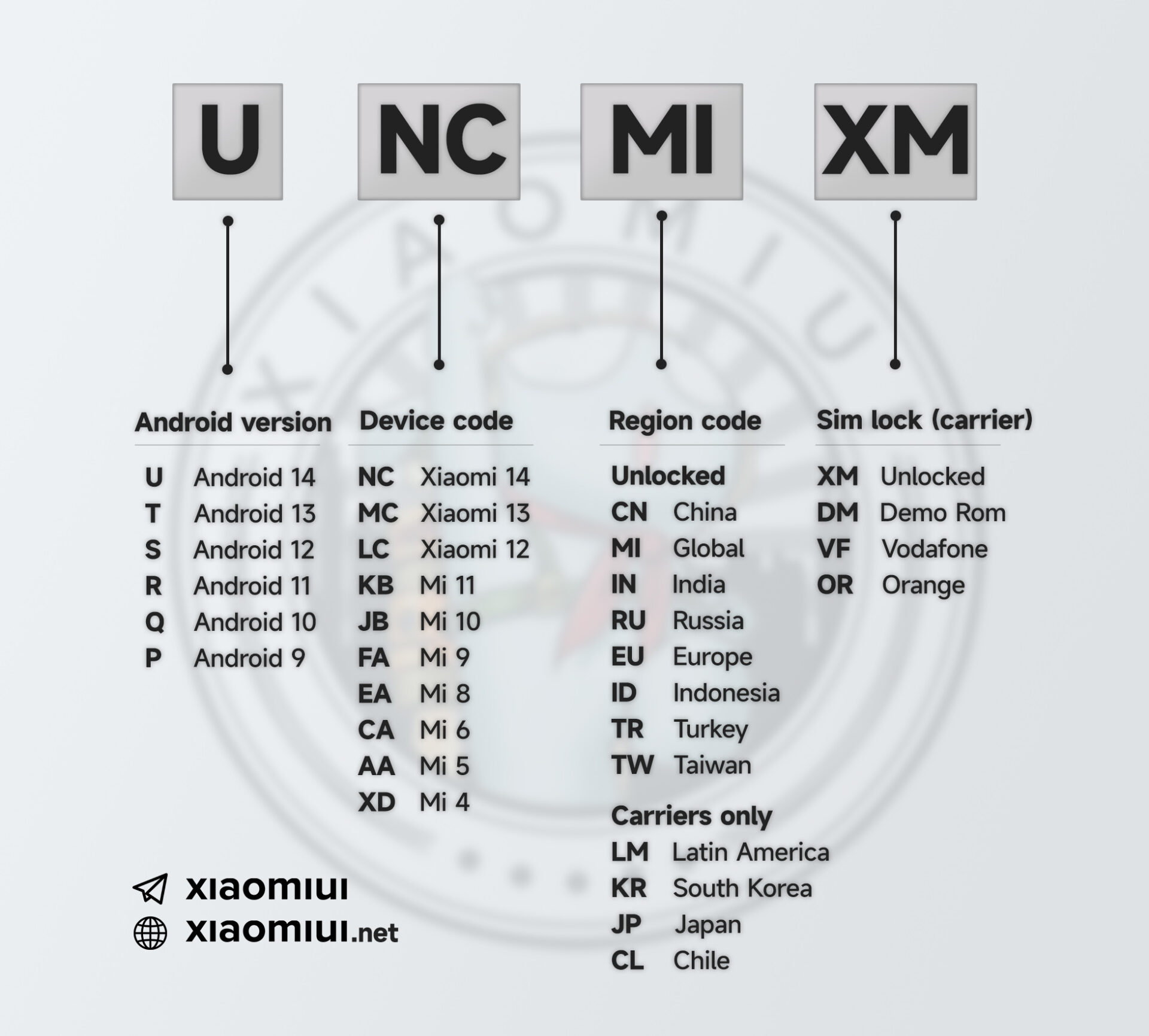

Just to make sure that your X14 is not a China dedicated device. Check pls Settings/About Phone/OS Version. If you have the OS Version OS1.0.31.0.UNCCNXM then you have a China dedicated device and you cannot use this AiO. If it is a different OS version the please check if you are using the same Xiaomi Account in both cases: to apply for or permission to unlock the bootloader (point A.4.) and connect your Mi Account to your device (point A.5. respectively B.6.). If your X14 is non-china and if you have used the same account in A.4. and A.5. then recall if your account is younger than 30 days. Other than that this AiO is (as you can see) very detailed and self explanatory. It should work with your X14 too.
Btw, if you are wondering on which region or firmware version your Xiaomi device is running, you can read from the (meaningful) firmware version number.
A very helpful guide on how to decode Xiaomi's version numbers can be found here.

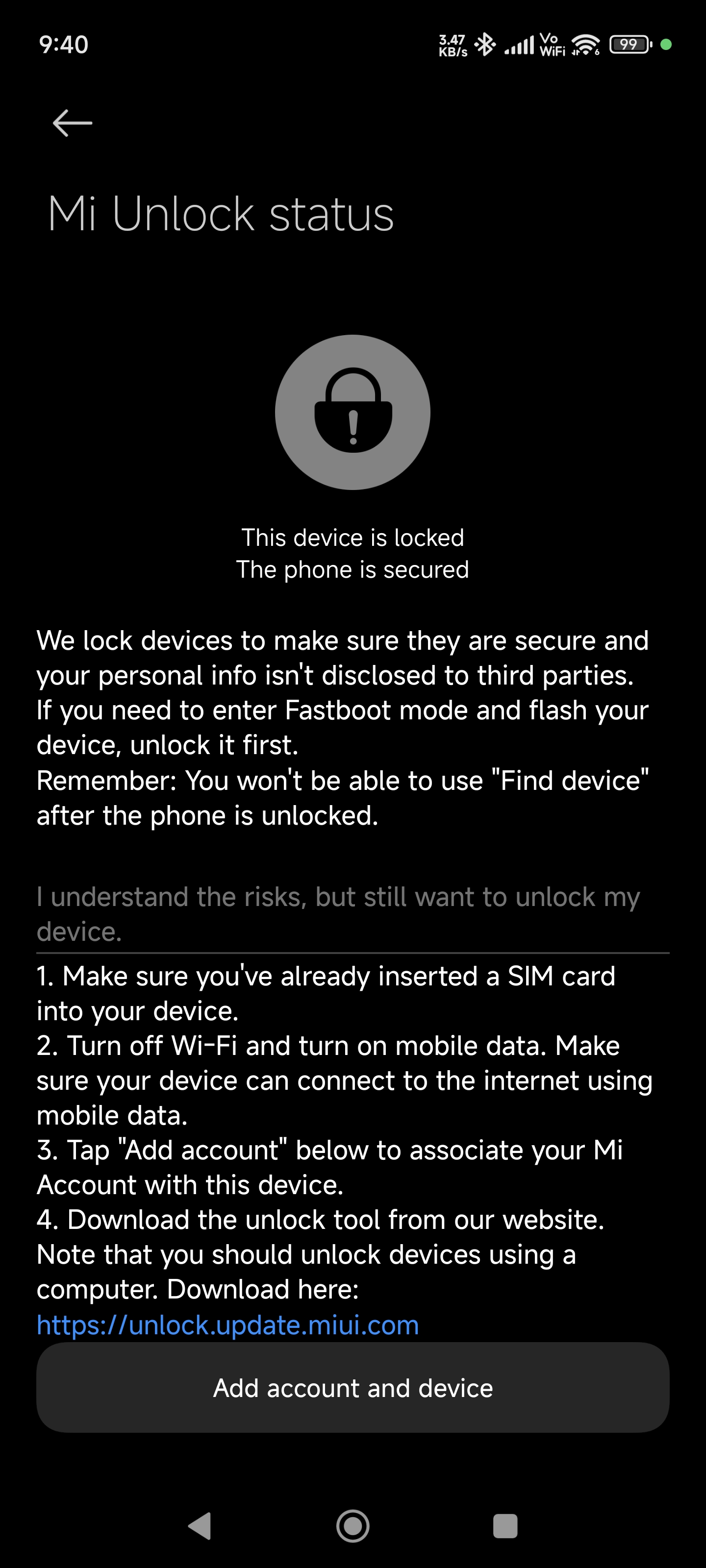

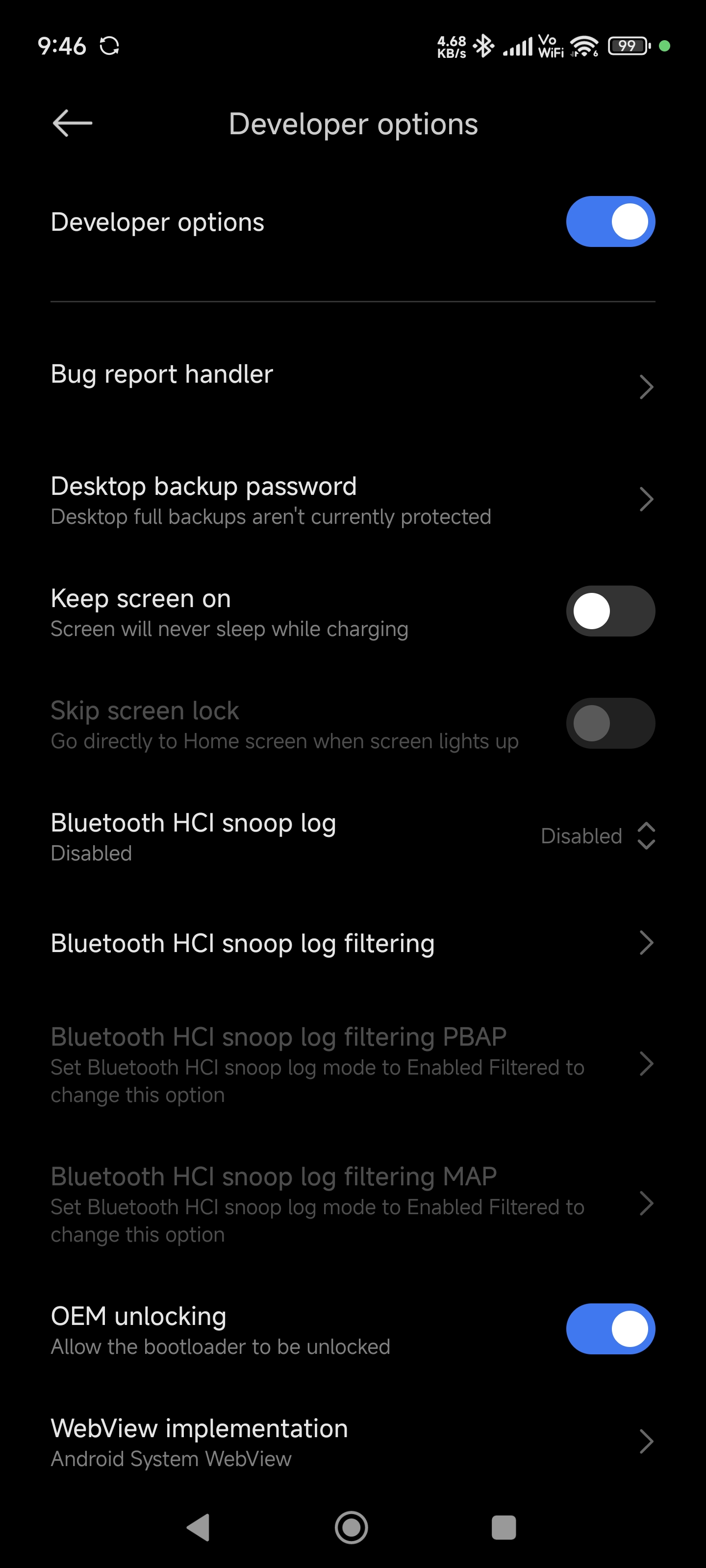

I have a global EA variant, I also have a community account in global region of the app even though I am UK.
I logged in to my account on my phone,
I applied for unlocking bootloader in the community app, it gives me 1 year of unlocking,
I set debugging, selected unlock in dev settings,
Added my account in the unlock section,
Checked again on mi.com to ensure the phone was bonded,
Went to fastboot, opened miflash 7.6.727.43 and went through the various warnings to complete first part. It says come back after 26 hours to complete.
If you have done the same with the same app version and region as me, then maybe get a different mi account or contact Xiaomi support. I hope the above will assist in checking your tick list in some way.
