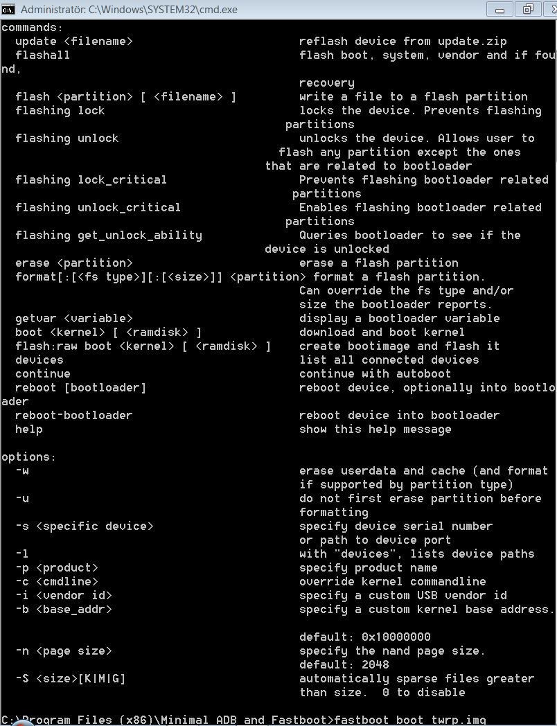

Hi ! I come to #15 type fastboot boot twrp.img and then it says "cannot load twrp.img : no such file or directory" i have downloaded and extracted and putted the img-file into the Minimal ADB and Fastboot folder. Anyone who can give me a hint ?
Check that the TWRP file you extracted and placed into the minimal ADB/Fastboot directory is indeed called twrp.img

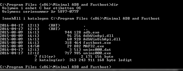

Could you running the
dir
command and post a screen shot of the output here?
Sent from my MI NOTE Pro using Tapatalk

We need you to run the
dir
command in that ADB/Fastboot directory and post the screen shot.
Detta är bättre
Ok, this is what I suspected - you did not put the twrp.img to your ADB/Fastboot directory.
1. You need to copy twrp.img to your C:\Program Files(x86)\Minimal Adb and Fastboot directory first.
2. Then you need to run fastboot boot twrp.imp

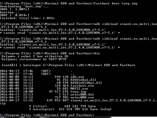

now problem with twrp program. can you look at this screen and see if somethings wrong
Looks like you are getting file names in the console wrong again. In this case, you are requesting your computer to sideload the file without providing the correct file name.Therefore the system can't fnd the file and thinks it doesn't exist.
Make sure files you are trying to load exist in the ADB/Fastboot directory and you are typing their full and correct names. In this case, type:
adb sideload xiaomi.eu_multi_leo_V7.2.4.0.LXHCNDA_v7-5.1.zip
