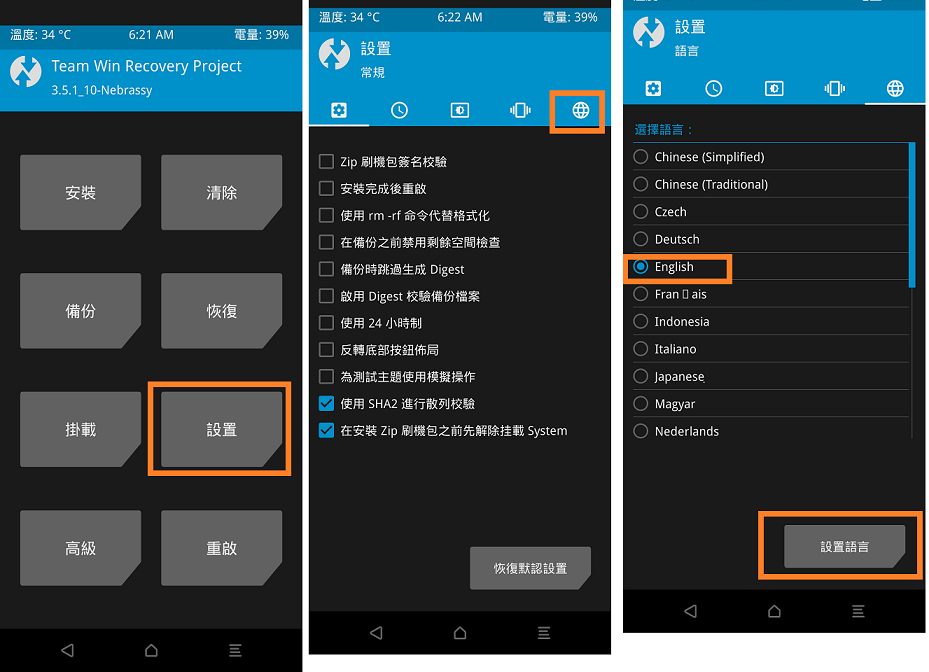

To change TWRP language to English,

Installation instructions xiaomi.eu for Mi 11 / Pro / Ultra / Lite 5G

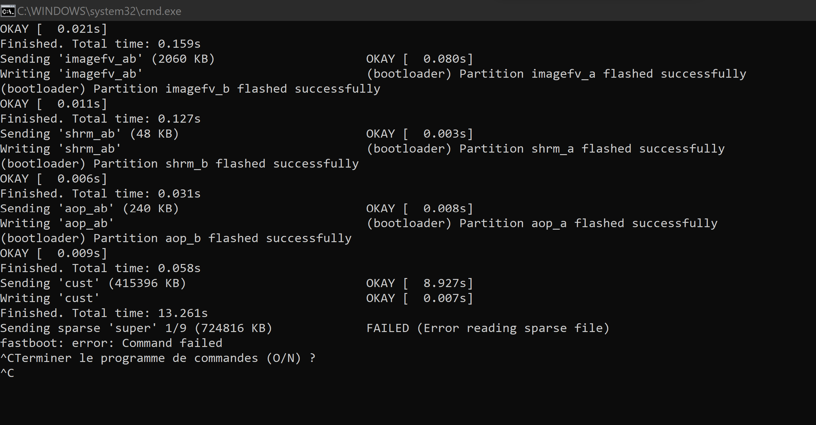

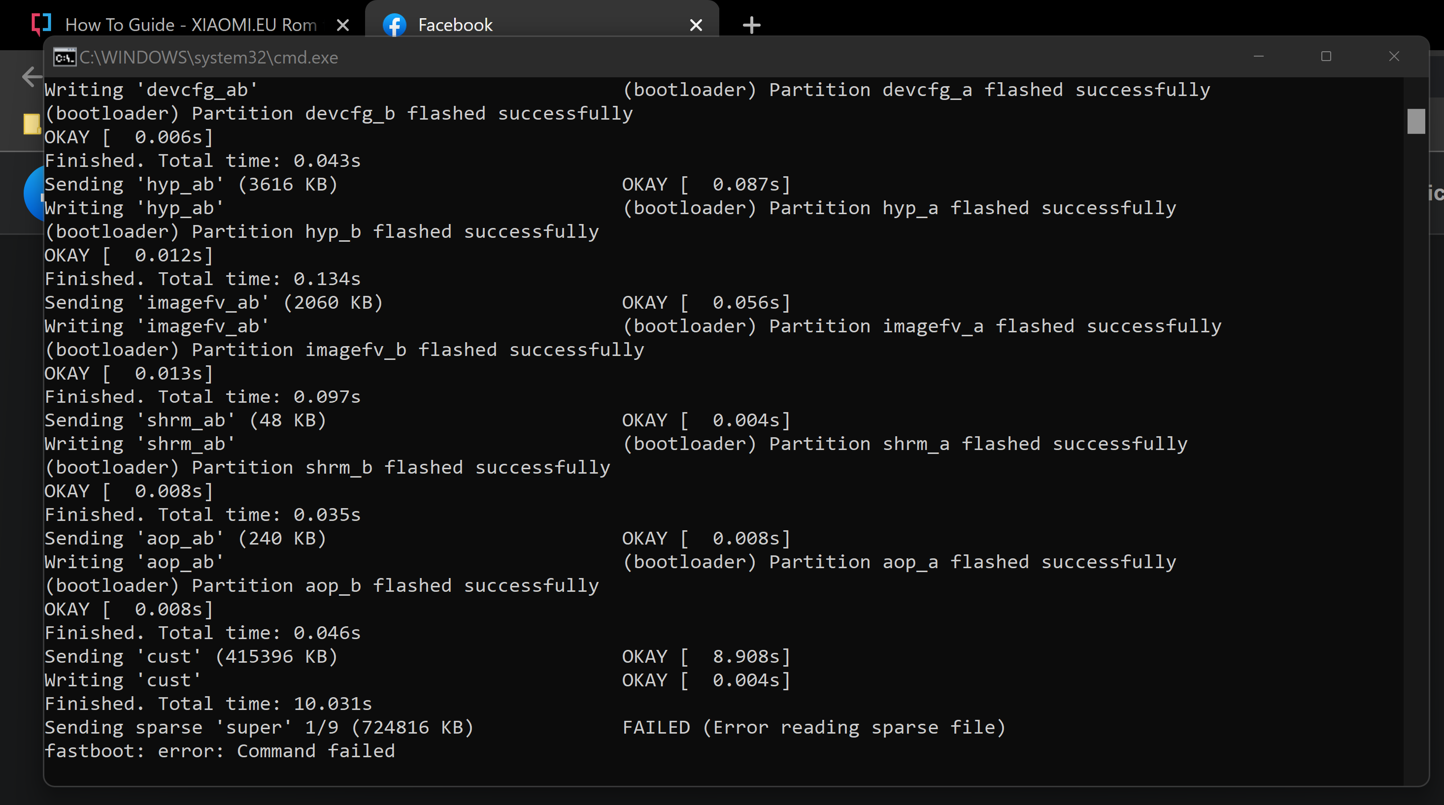

trying to upgrade my mi11 ultra (star) from 12.5 to 13 and am facing a recurring issue..
can anyone please explain this error to me ?
Sending sparse 'super' 1/9 (721168 KB) OKAY [ 15.817s]
Writing 'super' OKAY [ 0.009s]
Sending sparse 'super' 2/9 (786332 KB) OKAY [ 17.300s]
Writing 'super' OKAY [ 0.002s]
Sending sparse 'super' 3/9 (786332 KB) FAILED (Error reading sparse file)
fastboot: error: Command failed
searched and found a guy auto fix his issue by reinstalling a few times ... i spent the last hour reinstalling with the same error and no fix

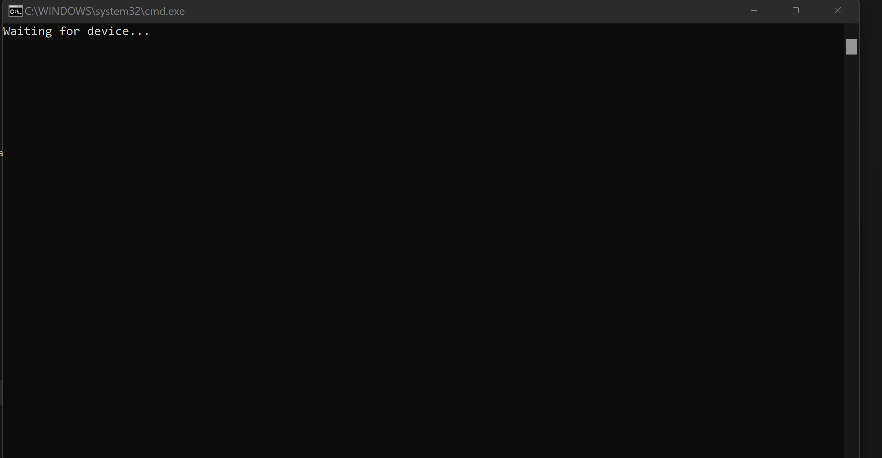

tried the fresh install .bat file in hopes of it might going thru but gets stuck on the same error..
Help T_T
fixed my issue using a regular usb a to c and not the usb c to c i use for everything

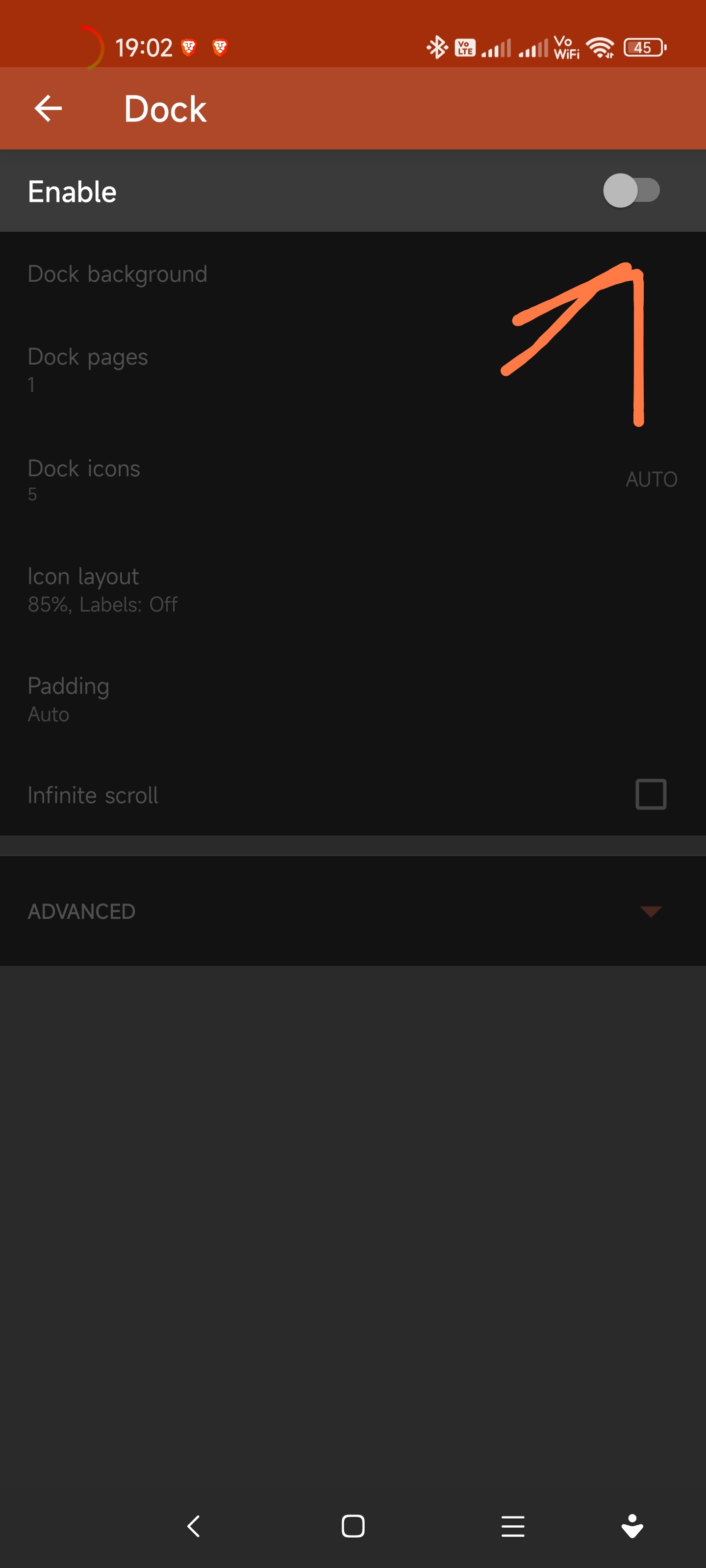

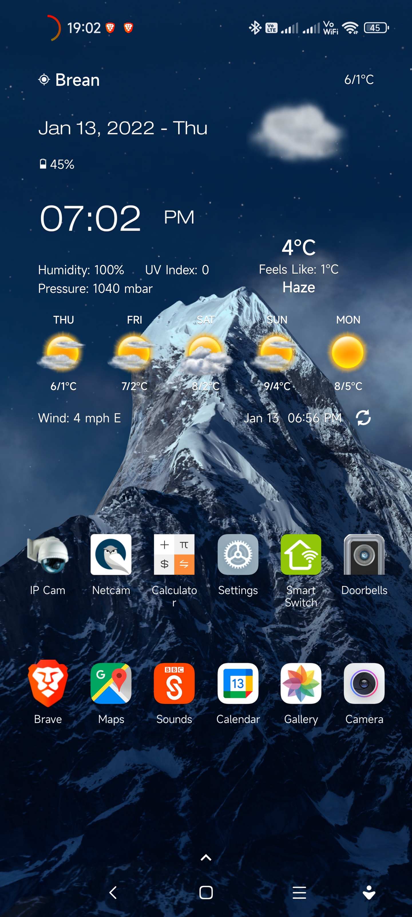

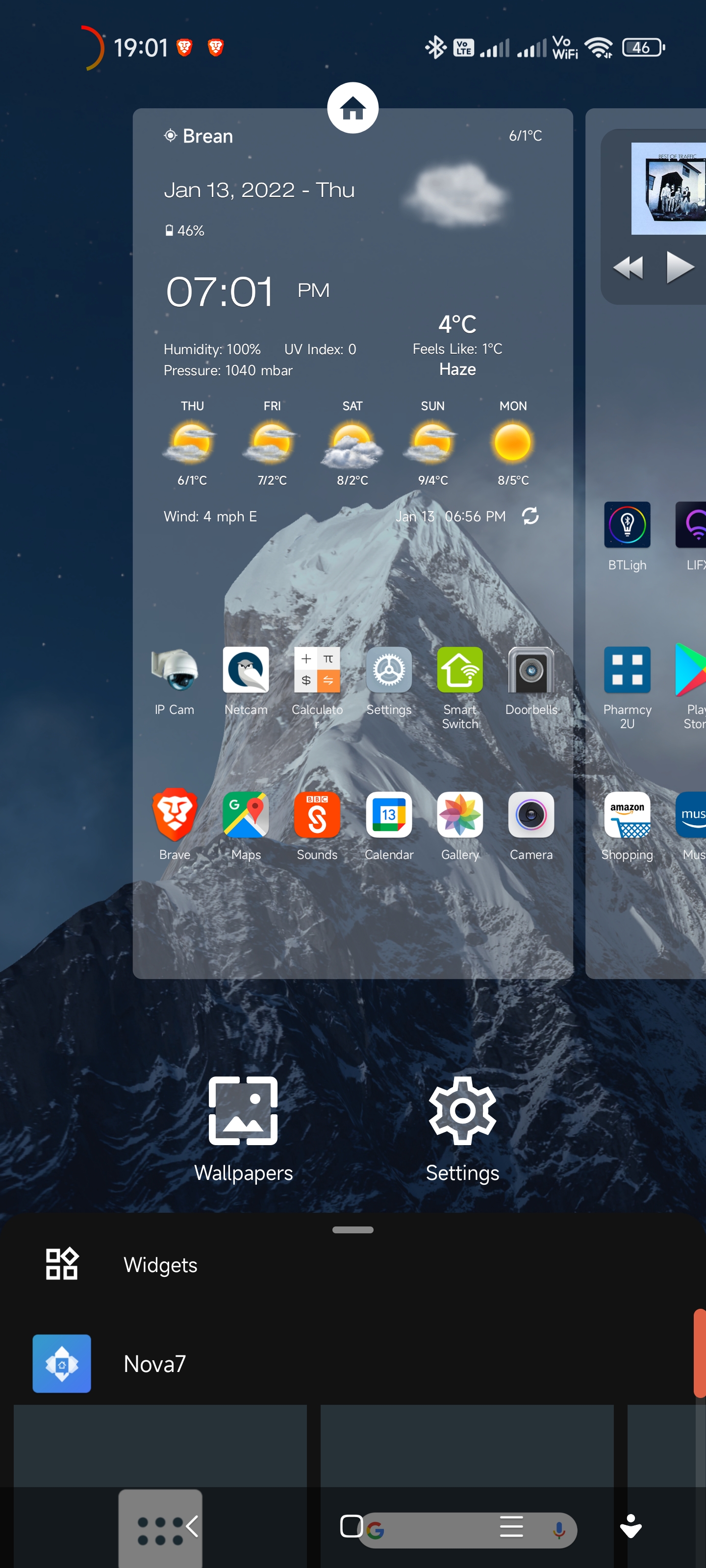

I installed the MIUI 13 / android 12 version this morning after my bootloader unlocked and it's just great.
I have noticed one thing, which is I guess in a compatibility issue with either MIUI 13 or Android 12 and nothing to do with the rom. A lot of the third party launchers don't work. Poco and Mint just give a black screen and Nova it all over the place. It's dock won't go away and it can't be uninstalled!! I suppose their devs will catch up once miui 13 and Android 12 get out there for longer.
Again, many thanks for a great rom. . .
I can just switch it off in settings. See screenshot below
Yeah, it doesn't matter if I toggle that switch to on or off the dock just stays there! I also can't uninstall Nova, I've tried all the methods I know and none of them will remove it. . .

So this is the fastboot method, and I have this error when installing rom :(
Any help would be nice, thank you !
Edit, I exit cmd and tried to restart process, now I have this message :
Phone is still on fastboot mode.
So I guess it's bricked if I try to restart the phone, I will have bootloop right ? Not sure what to do here....

Edit 3 : Restarted phone in fastboot mode, reebooted PC also, moved all files from image Rom to C:/ root of my PC in case, tried the operation again, everything runs fine until that same step "FAILED (error reading spare file)"
Then nothing else happens. What should I do ?
Edit 4 : Saw someone had more or less the same problem at the same step, I've tried again with a different USB cable, still stuck at the same step, same error.
If anyone can help me solve this, I would be glad.
I take it that you have downloaded the file again or done a checksum verify to make sure the file is not corrupted.
Next, I know you have tried but change the cable again, if you can use the original.
The last thing to check is that you are not using any other ADB files and are just flashing from the extracted files and folders of the download as is.
Extract files, connect phone in fastboot to pc, click on windows update bat file, wait till it reboots. The user files are in about 8 or 9 parts and they do take a while, so don't disconnect, leave it untill it reboots. Good luck my friend.
