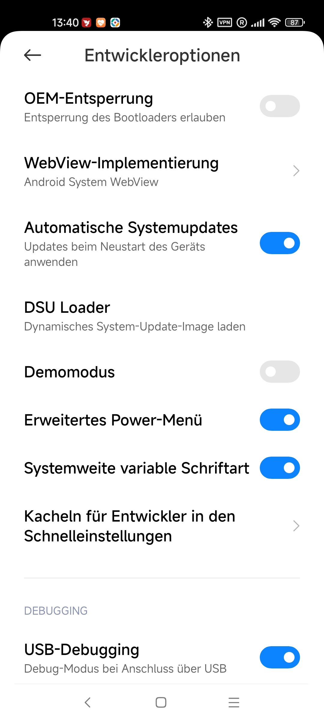

I didn't know that Xiaomi doesn't need USB debugging to flash something in fastboot mode. Xiaomi Mi 11 Ultra is my first Xiaomi device. I only had Huawei devices before and I personally always enabled USB debugging. (also at Xiaomi). When I connect the device to ADB, I get the RSA-fingerprint query, which I confirm. This authorizes my smartphone in ADB.
And according to your statement, it is not necessary for Fastboot mode with Xiaomi, but it is not really a mistake either.

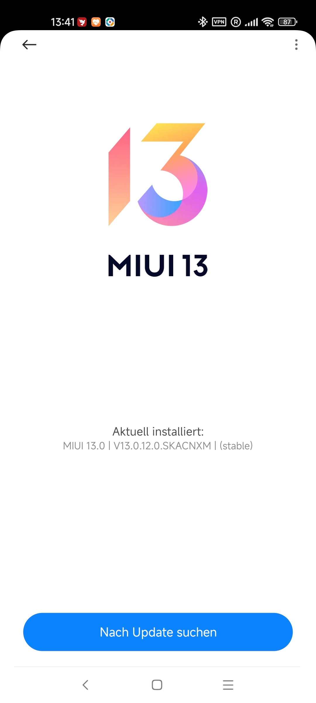

Things seem to work differently at Xiaomi. Example: I bought the device from TradingShenzhen with an open bootloader and the Xiaomi.EU Rom was already pre-installed at my request. For me, "OEM unlock" was disabled by default in the developer options (although the bootloader is open) and I can still update the ROM in fastboot mode.
That would be unthinkable with Huawei devices, since OEM unlock would have to be activated in order to be able to flash anything at all. So I have to rethink a little for my Xiaomi device, thanks for your help and tips.
