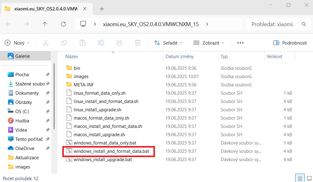

Installing fastboot method.
To use Windows:
- Unpack downloaded zip file in the PC (we recommend to use WinRAR)
- Connect to PC via USB cable
- Run the quick launch installation script as an administrator from the unzipped zipper. windows_fastboot_first_install_with_data_format.bat
- wait for the phone to restart the system
- After reboot its done (first boot may take up to 15min)
- if flashing process stuck on setting slot a, just press Enter

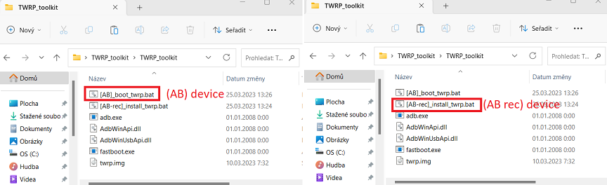

- download the TWRP toolkit
- Unzip the downloaded toolkit.
- download TWRP
- insert the TWRP renamed twrp.img in the toolkit folder,
- Install TWRP using the script according to your device type.

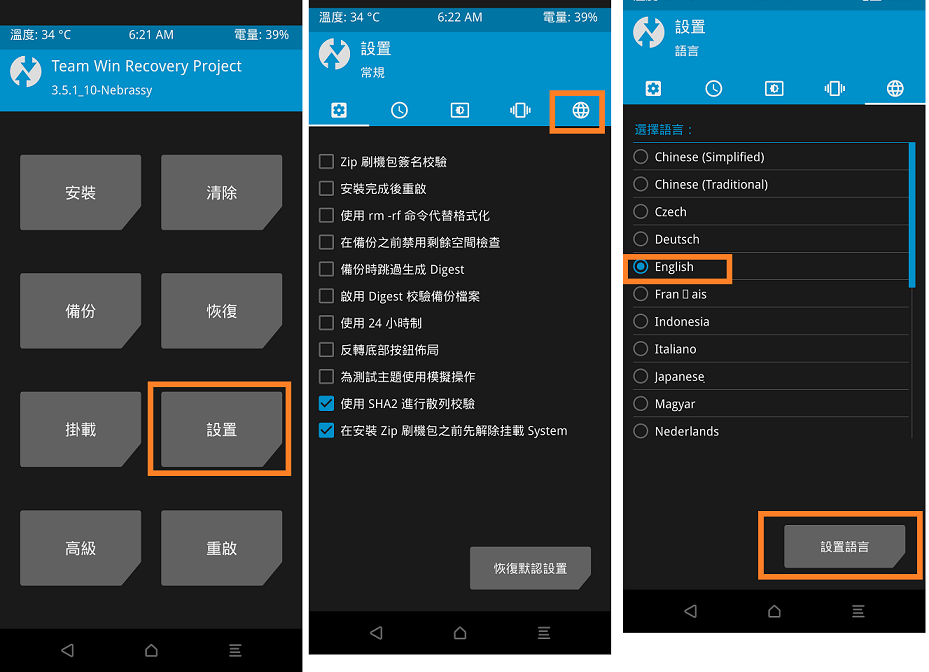

To change TWRP language to English,

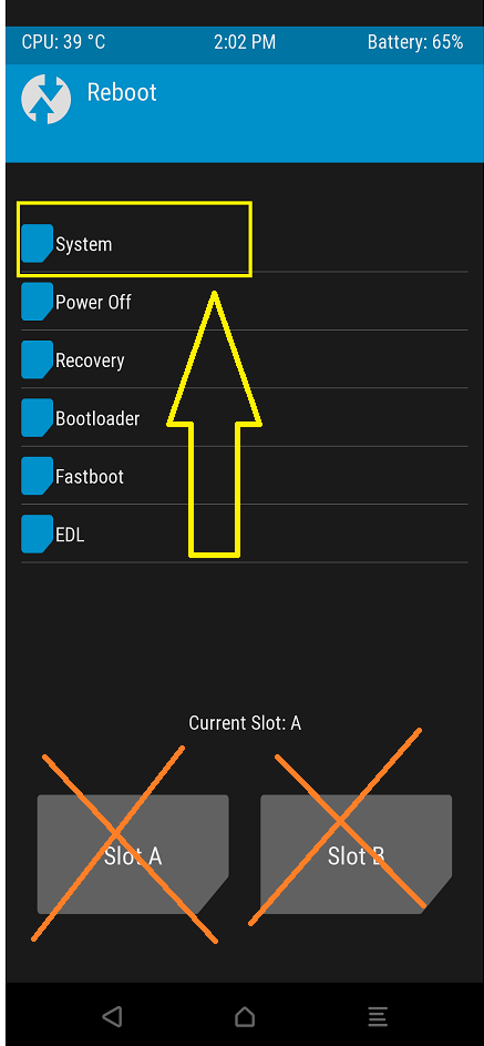

restarts the system after formatting is complete
- DONE
wait for the system to start, the first boot may take longer.
After installing the ROM, TWRP remains
