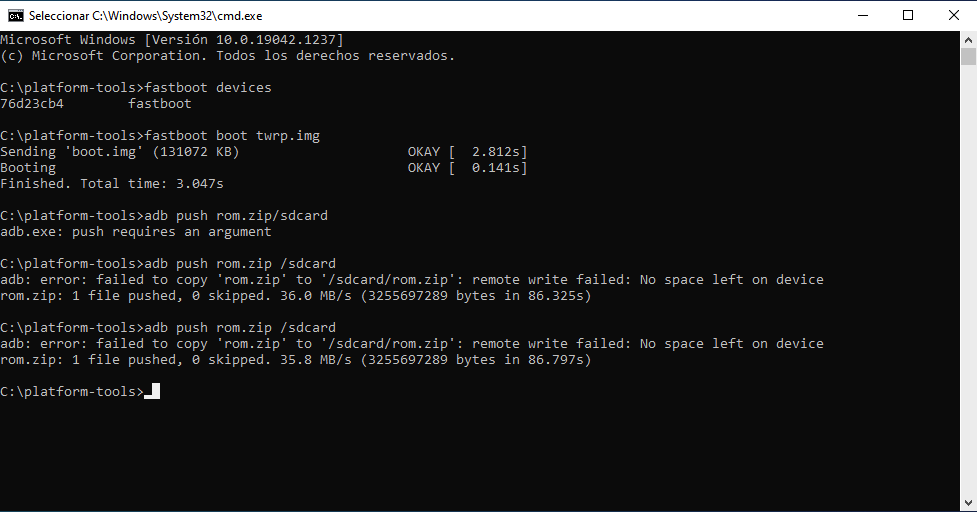

Hello! I have some issues with the command "adb push rom.zip /sdcard". Everytime I try to do it, it show the process of copying, but when it reaches 100%, it tells me it failed because my phone is out of storage (even though I formated the data as said in the instructions). I can clearly see in TWRP that says that my phone has the 128 GB free of space. What can I do? I've seen video tutorials where they install the rom first and then factory reset, not the other way around. Is it safe to install first and then factory reset? I wanna stick to the instructions written here, but I'm stuck in this step. Please help!

Hello, replace " /sdcard " in your command by " /data/ " and it should work. ;)
EDIT: Of course, the ROM file will be located in the /data folder. ^^
