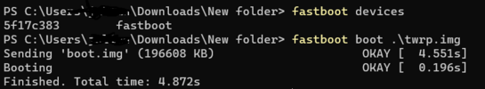

Tried to flash TWRP sticking to installation advice in the first post and using the most recent twrp version for mi 11, after executing fastboot boot twrp.img and rebooting the phone the TWRP isn't on the device - still the chinese recovery. Any idea why?
Thanks for that helpful reply. I already had twrp installed before, but due to a ROM update it got removed.
Used as mentioned the latest version for venus - executed fast boot command (as written in the instructions). How long should it take to reboot into twrp recovery? since it does not reboot, at least not for about 5 minutes. after doing it manually the recovery isn't there ( I guess it shouldn't be there).
After entering the fastboot command, TWRP should boot up within a few seconds.
You can't manually run TWRP because you don't have it installed.
Does your PC see the phone in fastboot?
Enter the command:
fastboot devices
yes, I see the device and the fastboot boot command displays Sending ... and Booting - so basically the output like it would be successfully executed
That's useless.. Why don't you put the whole window here?
Enter the commands:
fastboot devices
show full CMD window

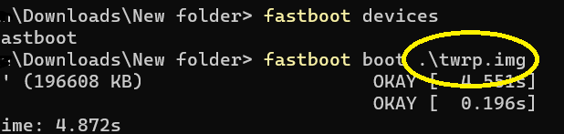

Do you have correctly named TWRP?
Did you enter the correct name of the TWRP file in the command? Why do you have ".\" in the twrp name command?

yes the file is named like this. "./" is marking the current directory, its added automatically because of autocompletion of the shell
EDIT: Found the issue - seems like the usb-c cable was the issue. Trying another one fixed it - thanks.
