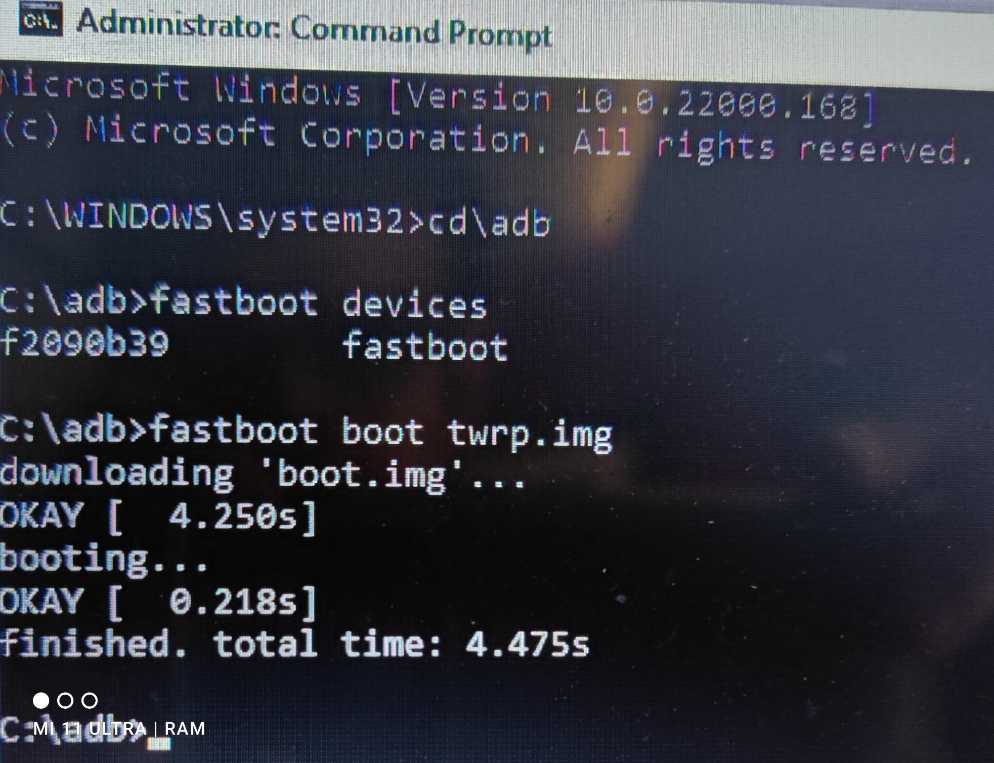

I have Mi 11 Ultra. I managed to unlock the bootloader via the tool.
I put the phone in fastboot mode and when I type "Fastboot devices", the phone is recognised. When I type "fastboot boot twrp.img", the phone screen goes blank and then phone boots in to MIUI. I tried multiple times and still no success. I am unable to boot the phone into twrp.
Please help. I am unsure what I am doing wrong.
Recovery that I am trying to use is "Mi11Ultra(Pro)-twrp3.5.1-recovery-21.5.9-decrypted.img".

What's your current ROM's version? You may need to update your ROM first. ;)
Simple question,did you put the twrp image into your adb folder first?
Yes. When I run "fastboot boot twrp.img", the command executes successfully. The phone reboots itself and goes directly to MIUI instead of going into TWRP.
Did you renamed the image into "twrp.img", sorry asking but I need to rule out common mistakes.
you use the windows cmd prompt right? I hope you are not using poweshell
you use the windows cmd prompt right? I hope you are not using powershell
Yes. I renamed the file as twrp.img. I am using command prompt only.
