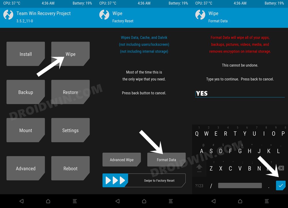

Installing with TWRP:
1, Download Xiaomi.eu ROM zip file to PC xiaomi.eu_multi_HMK30Pro_V14.0.5.0.SJKCNXM_v14-12.zip
2, Reboot to TWRP
3, Erase -> Format data -> YES
4, reboot recovery
5, connect the device with a USB cable to the PC and copy the ROM to the internal storage of the device
6, Install the ROM
7, reboot system
8, Done!

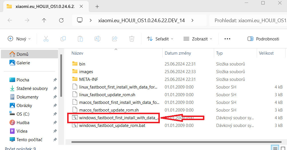

Installing with Fastboot:
  • Download Xiaomi.eu ROM zip file to PC
  • Power off your device
  • Connect to PC via USB cable
    - first_install_with_data_format - with data wipe,
  • Done!
2, Reboot to TWRP
4, reboot recovery
6, Install the ROM
7, reboot system
8, Done!
  • Done!
