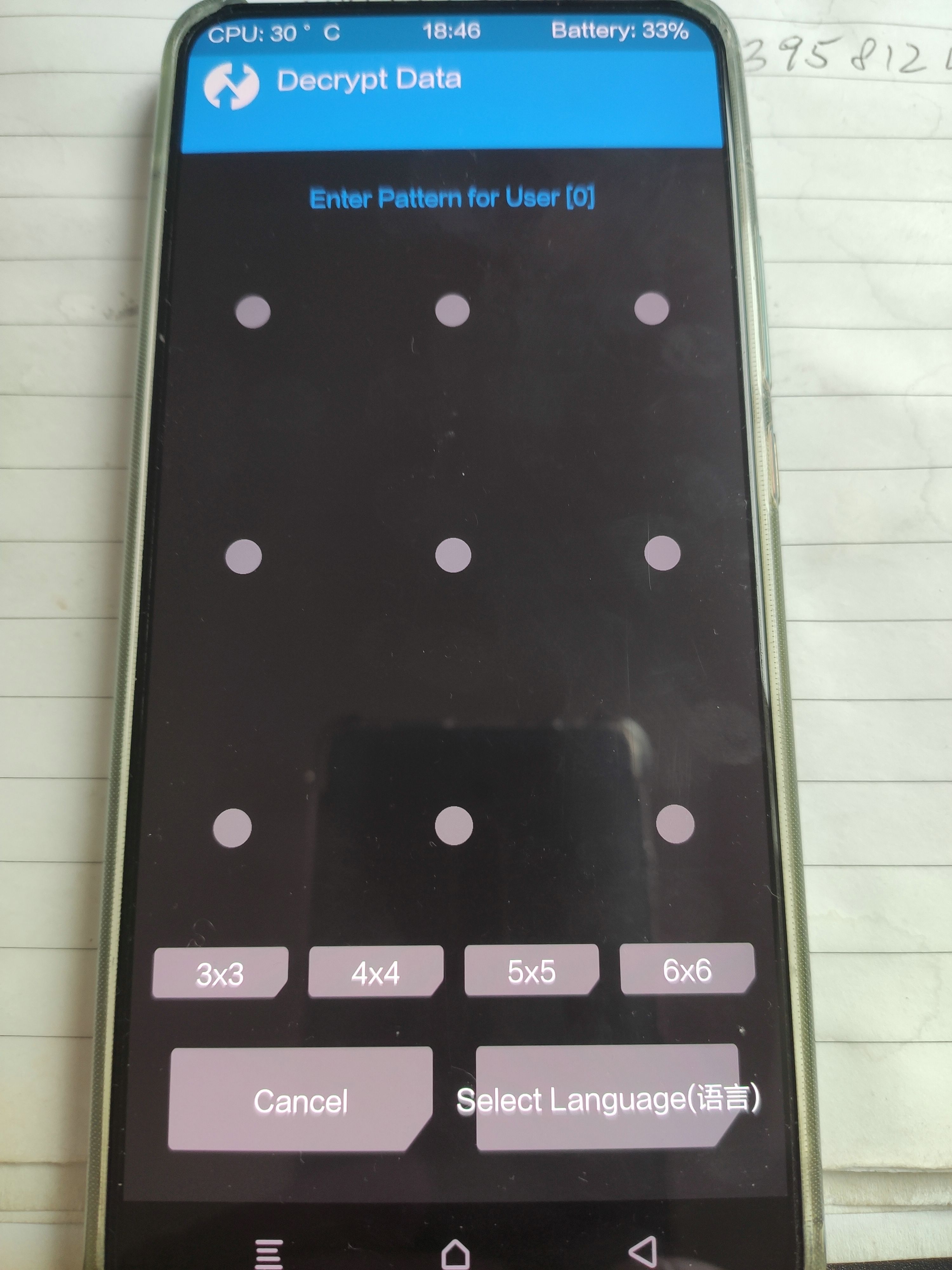

I am on latest Xiaomi.eu weekly 20.11.18 beta, TWRP sticks and i able to decrypt data partition.
