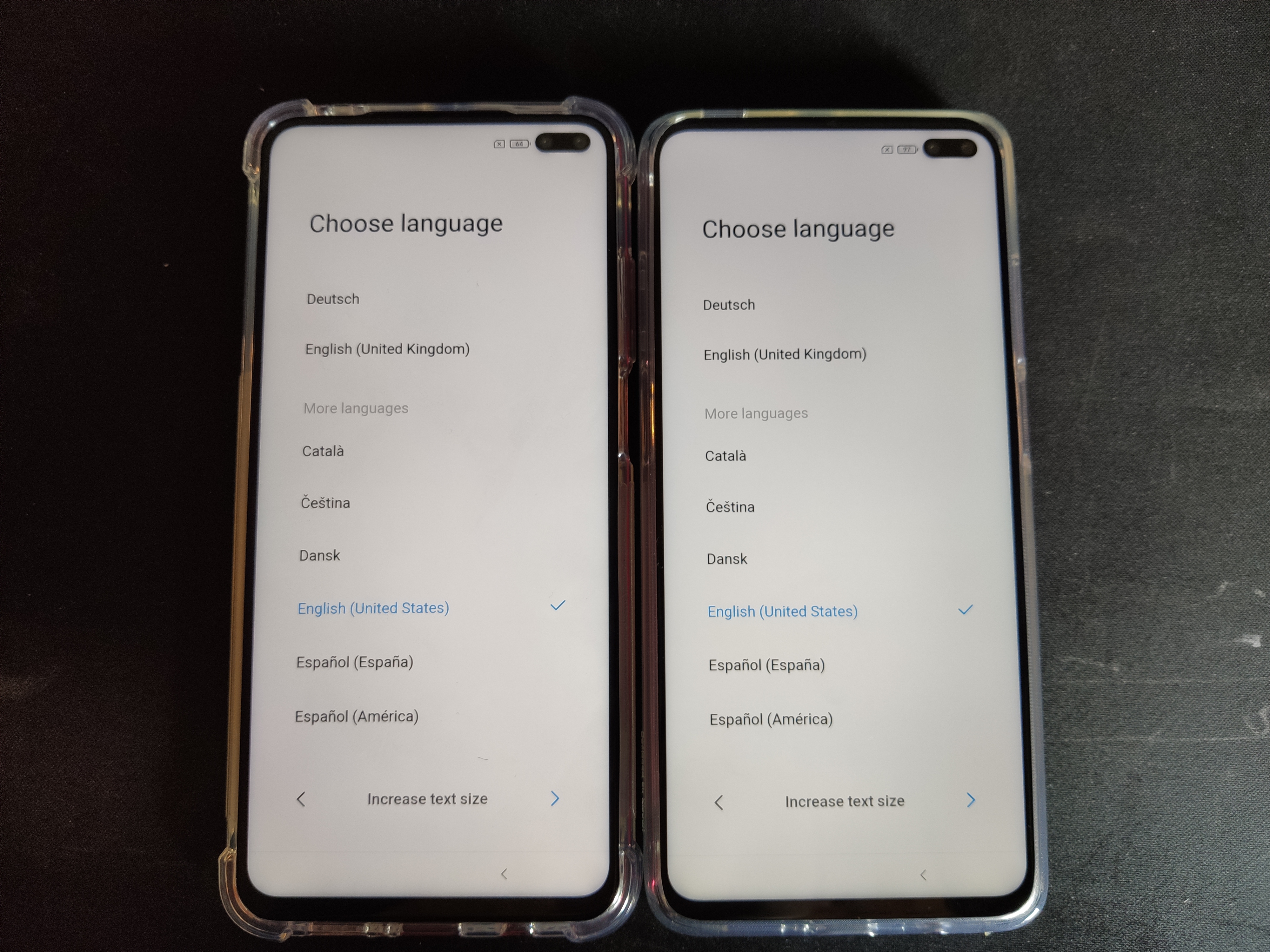

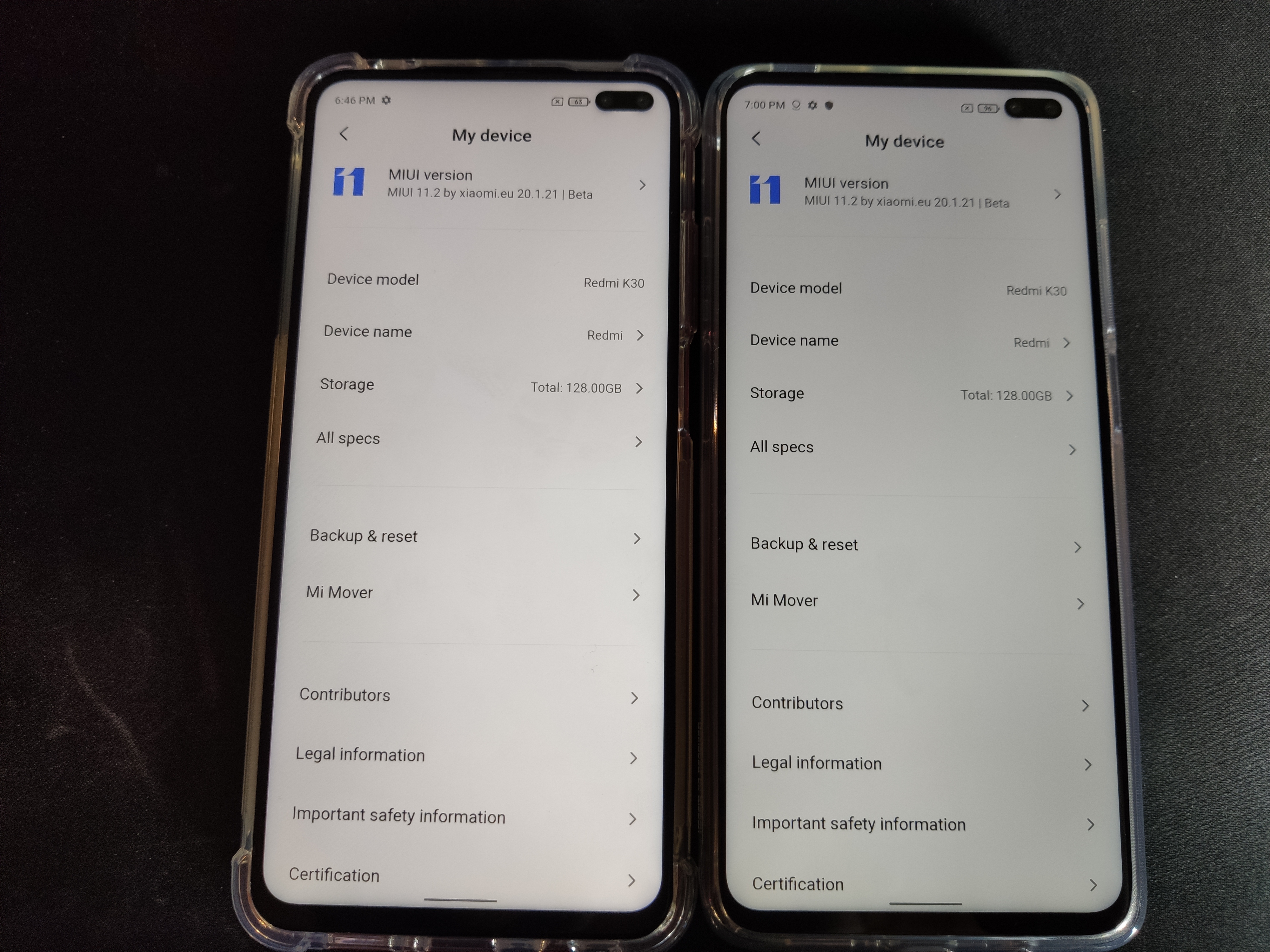

Yay! Thank you for having found a way to still flash the ROM, regardless of whether we have TWRP or not!
Gonna try it on my 2 K30s in a bit, I'll edit this post to give a status update
//EDIT: Yep, got them working! Neat!
