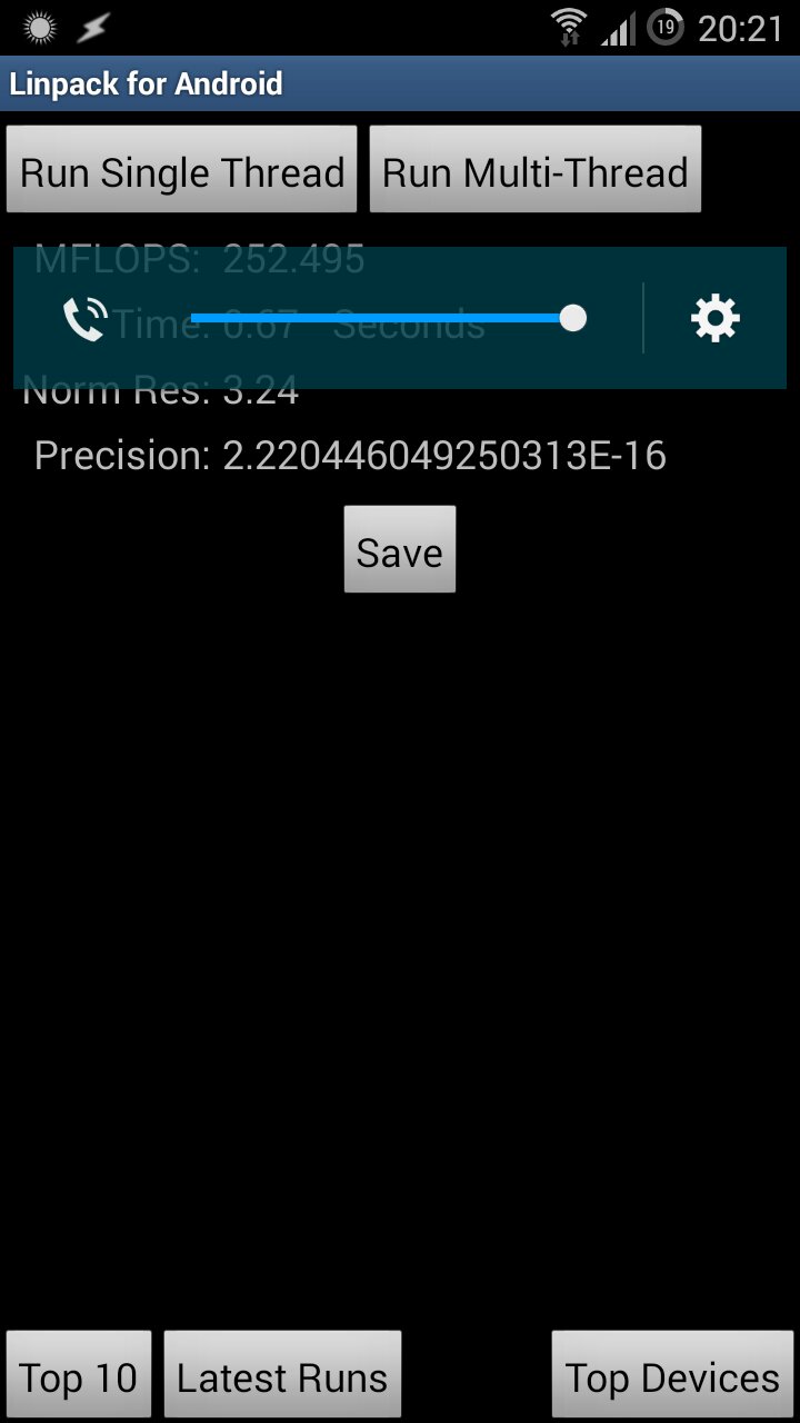

All who flashed OC kernel can you post some screenshoots of Linpack test or to be more specific Norm res value,because after OC i get sometimes random norm res value.

Intellidemand 1.7ghz fiops gpu 450ghz
Same as before but gpu 585
Thanks a lot on these.
I need to ask did you ever get unknown precision or other number 3.24 on norm res?
Also if you could please upload your voltage table you were using for these tests.
And one more thing,try to undervolt by 100 or 150 MV and post here if result changed.
I did get inconsistent precision results but always 3.24 every time.
I was undervolting by 100, if i set it to 150 my phone locks up and i have to reset.

i used linpack and the Norm Res is always 3.24, with undervolt by 100 and gpu with 450 and 585. Governor INTELLIACTIVE and I/O ROW
the MFLOPS go from 350 to 624, and always change
in Precision i got "inconsistent result" or a lower result: "2.22E-16"
