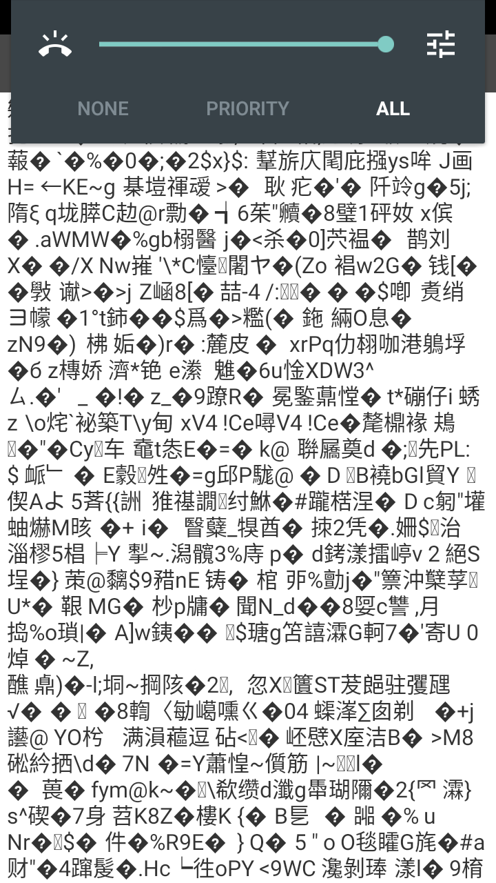

I'm esexplorer but I'm unable to find efs folder in / drive I tried to search but it not there..I have rooted my device

Seems that efs partition are located there
/dev/block/platform/msm_sdcc.1/by-name/m9kefs1 2 3
Can you check the content there ?
Sent from my nexus 10
Its in Chinese screen shot attached

Sorry I gave you the block devices path. Those are not mounted. Thus you would need to mount them and then edit the content.
But honestly the easier for you would be to downgrade back to kitkat and use xposed to get rid off your problem with the proximity sensor.
