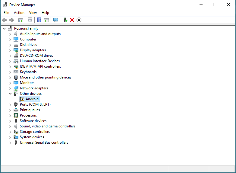

btw i just found out when i was in fastboot mode for that breif seconds, i discovered that my drivers are not properly installed in Device Manager. as you can see in the screenshot, i am unable to install any drivers because it would come up with "windows was not able to install your android"

i've finally found a solution that was totally worth it. didn't find any article or tutorial about this one so i guess i should explain what i've done. so everyone here knows that i can't access bootloader, and turns out there are some drivers that were not installed properly. well while i was in that brief few seconds in fastboot mode, i used the command "fastboot oem edl" which made the faulty driver appear in device manager for a few seconds while my phone is still alive.
so in that brief moment i took the chance to install a driver from intel corporation, called "intel android bootloader interface". after i did that, instantly i saw the faulty driver from the device manager list transformed into "Android device - Android bootloader interface". then i gave the fastboot mode a shot by using "adb reboot bootloader" and i was ecstatic when i saw my phone was not showing any sign of rebooting.
long story short, install proper drivers for it, it may be rare, but im glad i fixed it. now i am unable to unlock bootloader with ease. no problemo.
