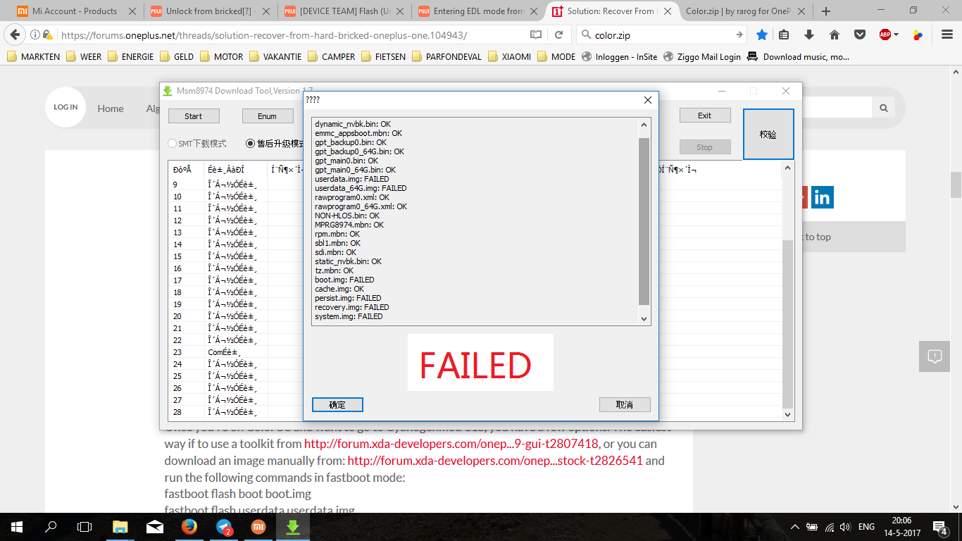

Found a programm called color.zip which scanned my com-ports and after that made a report of what is wrong with my phone.
This report is attached.
Some files are corrupted, I don't know how this could have happened.
But, it is what it is...
Now the next step...how do I repair this ...

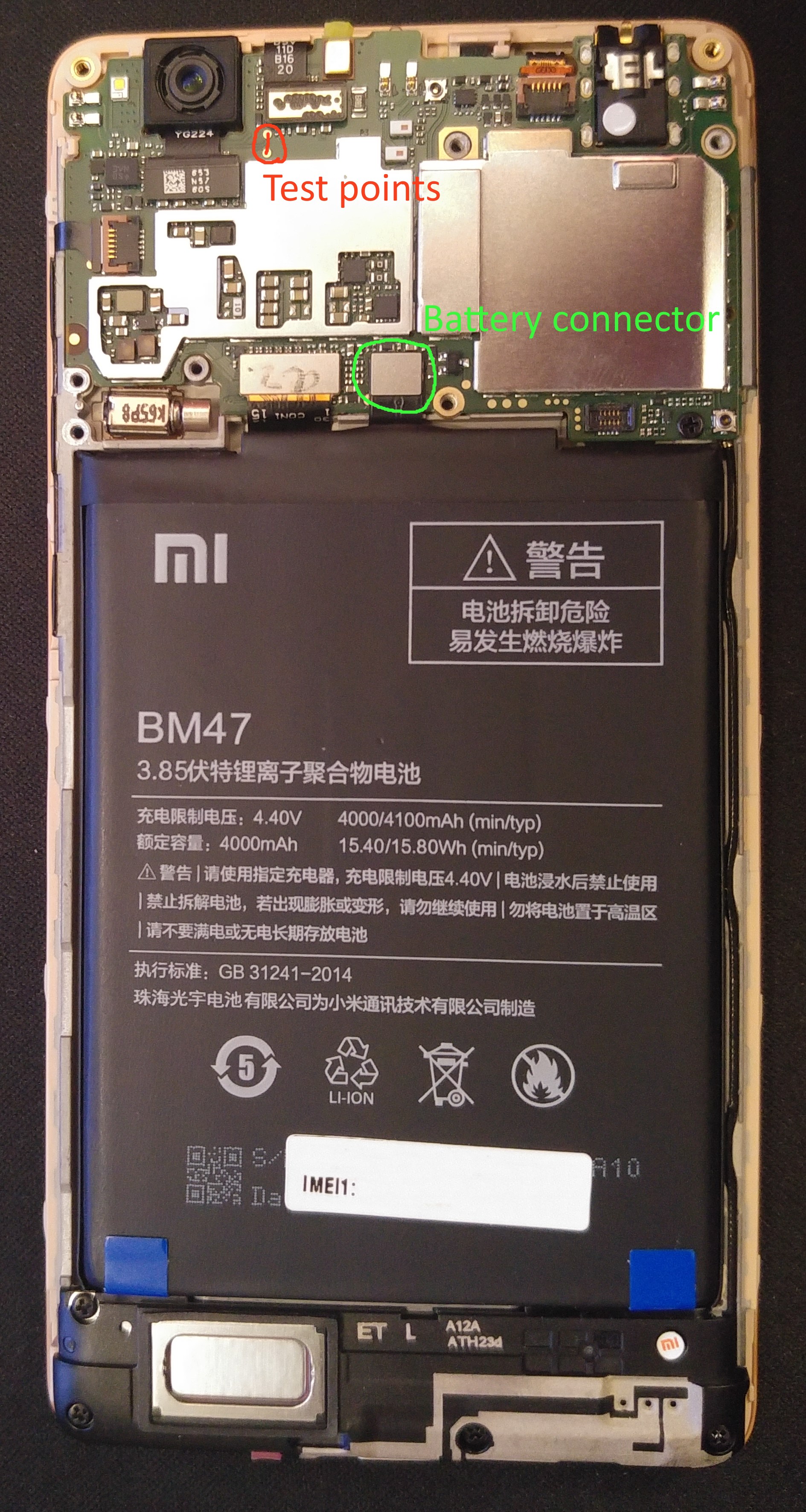

I was in similar situation with my Redmi 3S (with 3GB ram and 32GB rom). After I had tried to flash global rom several times to the phone it was detected as "Qualcomm HS-USB Diagnostics 900E" by my PC. Then I found out the location of the test points on the motherboard and I managed to get it working again with global stable rom (previous was china stable). My device still has locked bootloader as I'm waiting for unlock permission. Hopefully you can find help to your situation from my post. You probably should clean your device drivers if you have manually forced them to be different. I did not do any manual device driver configuration in my Windows 10, it found the correct ones automatically.
I cannot give any warranty for the information I give, but I got my bricked Redmi 3S phone working with these steps:
- I recharged the battery with my USB charger for couple hours to be sure it had charge
- Disconnect USB cable from the phone
- Removed back cover
- Removed internal cover from motherboard held together by screws (one under MI -sticker)
- Removed battery connector
- Reattached battery connector
- Connected phone via known good USB cable to PC (connect straight to PC motherboard USB ports, do not use any USB hubs etc between phone and PC)
- Shorted the test point pins while holding "power" + "volume down" -buttons until device reboots. I used metal tweezers for mobile phone repair I got from ebay as the pins are small & there are components near.
The device should now be recognized as Qualcomm HS-USB QDLoader 9008
Which means you are back in EDL-mode
- Flashed official Xiaomi global stable rom via miflash with "clean all" selected.
- After miflash had successfully flashed (took around 230seconds on my PC) I disconnected the phone from PC and removed battery connector.
- Reattach battery connector and press power to normally start phone. I was welcomed with normal MI-logo and the first start took somewhere near 15minutes.
The filename for the rom I downloaded from Xiaomi servers was: land_global_images_V7.5.9.0.MALMIDE_20160805.0000.29_6.0_global_470b843c10.tgz
The version of xiaomi flashing tool / miflash I used was "Miflash 2016.08.30.0" I got from Xiaomi flashing guide "method 3. fastboot upgrade" page.
I'm hoping to flash xiaomi.eu rom after I get the bootloader unlocked so I can install TWRP, but now I have again functional phone. :) I attached two pictures to this post, one with clear picture of motherboard and one with test points circled.

Samsa!
Thank you! You saved not only my phone, but me, my sleep and rest , cos I'm absolutely Exhausted for reading and watching uncomplete manuals/videos for the last 8 days/nights.
Thank you once again!!!

WOW you saved my phone! Just to inform other ones, that your procedure is the only one that worked for me. Even if I couldn't see the Xiaomi Logo (my screen showed nothing, neither the LED was blinking), I could improvised a little bit with the timing (I did it pretty quickly after realesing the buttons) ... It's the only method that managed to avoid any error with my MiFlash Tool. (I used the beta version). To connect it to the PC it's easier to use a deep flash cable. And before connecting it to the PC, you should disconnect your battery for some seconds, like tommyboy7 already said..
