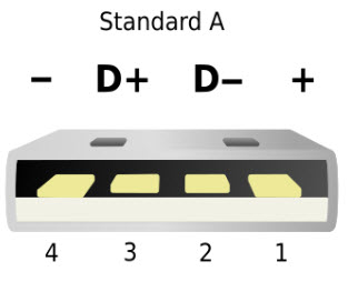

Here is an easyer way to enter download mode :
1. device off
2. connect black(gnd) and green(D+) wires of usb cable (you just Can peel it off no need to cut wires)
3. connect micro usb to your phone and in a few seconds disconnect green from black wires
4. wait a sec......and everything ok you will see ......qualcom 9008.....etc
This is our "beta" version of cable....

Tried to connect USB Pin 3 and 4 for several seconds and finaly it worked. Flashing Rom :) Big thanks!

It worked! I used the cable method, I did it a little bit different, but it worked and now I my Redmi S3 is working again :D
I say it was a little different because I connected the USB with the copper wire, I removed the USB (and copper) and connected it again in the other port next to it without the copper and the device was recognized as Qualcomm 9008 :3

My situation was the same as that of Antimatter (only MI-logo or Fastboot screen). I made a primitive deep flash cable and shut down the device as explained by crawler009 . I found that I had to shortcut the green wire to the ground (i.e. the black wire) while holding the power + volume down buttons (for 10-20 seconds), then releasing the buttons and breaking the shortcut. I had to try quite a few times before it worked (possibly a bad connection in my cable). When QDLoader 9008 was recognized I flashed the newest stable official MIUI 8 rom installed (20161208) using XiaoMiFlash(Beta).
