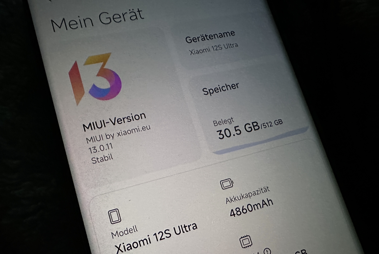

Man, what an act. Would say that you take it up in the OG post. Because if you want to the current recovery ROM (first time) it doesn't work. Stock to recovery .eu don't work. It must be really unfortunately cumbersome the last fastboot zip then flash TWRP on it and there you go with recovery xiaomi.eu ROM
Thanks to the people for answer and specially @gogocar62 for the support, I was on the verge of giving up. Never had anything so mysterious ‍
