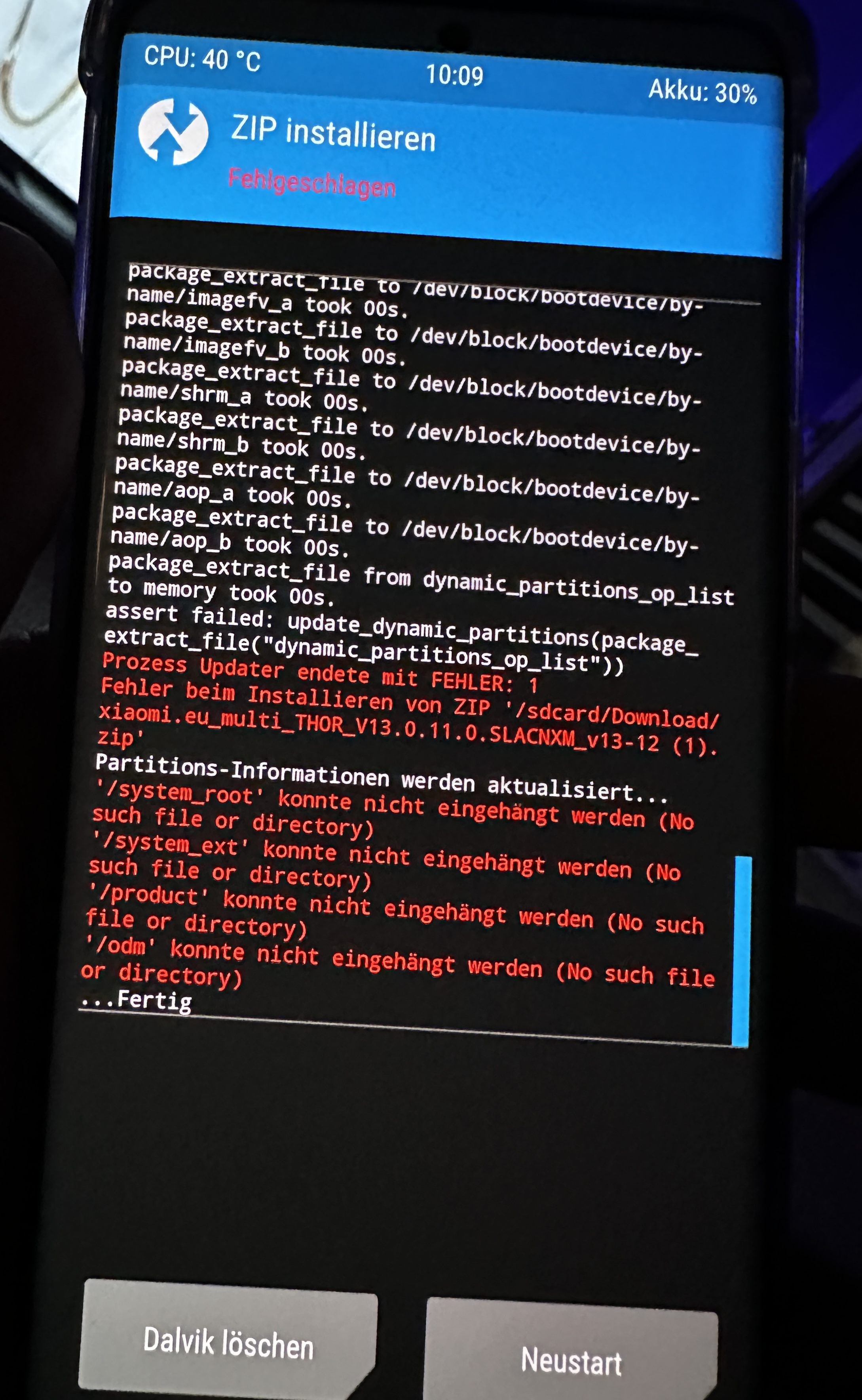

Try this instruction, just install and want to reset but install fails. I don't understand it. Am in the field for many years and flash surely 50+ devices.
TWRP update shows ERROR: 1 / can not mount system ...
- Solution:
-> while you are in TWRP reboot your device in recovery mode
-> try to install the rom again
-> if it will fail, reboot in recovery again
"reboot recovery" means to restart TWRP Recovery from TWRP "Restart - Recovery"
-> sometimes you need more then one try (Repeat the process until the installation succeeds.)
Oh didn't see that before. Thank you it works after 2 reboots to recovery. After install i reset and now it only boots to twrp. I do reboot system and show white MI logo then goes to twrp? Twrp show internal (0 mb)
