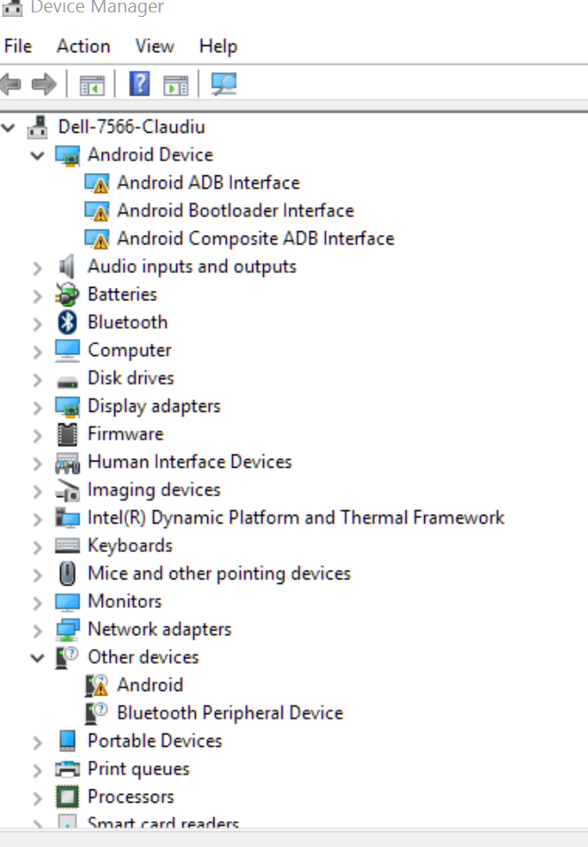

device manager in w10 looks like attached image

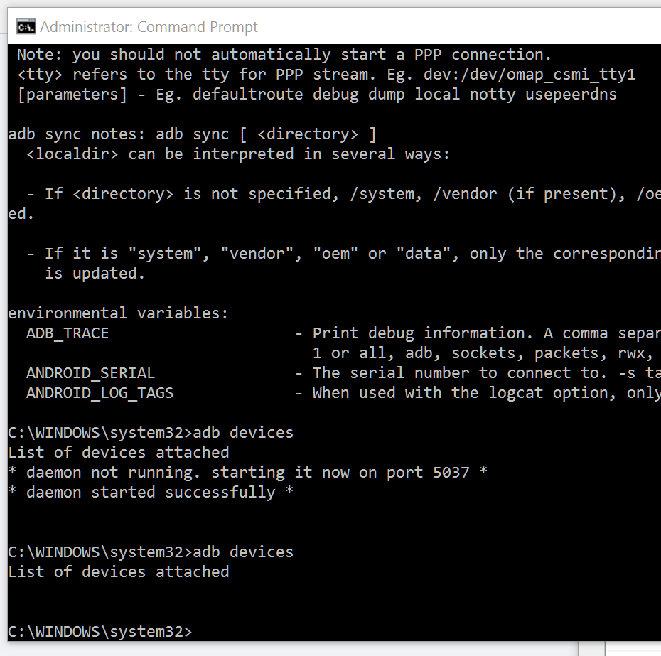

You should get a response from adb device info.
Also you you should get a serial number returned after you enter: adb devices
That lets you know the device is connected.
Did you install the ADB setup?
i installed...but no device as attached image shows
Strange place to have ADB installed? but anyway as far as I know Mi Unlock tool has its own drivers & maybe you have a conflict somewhere.

Need to fix that driver issue, you shouldn't have exclamation marks for adb if its connected in fastboot mode.
