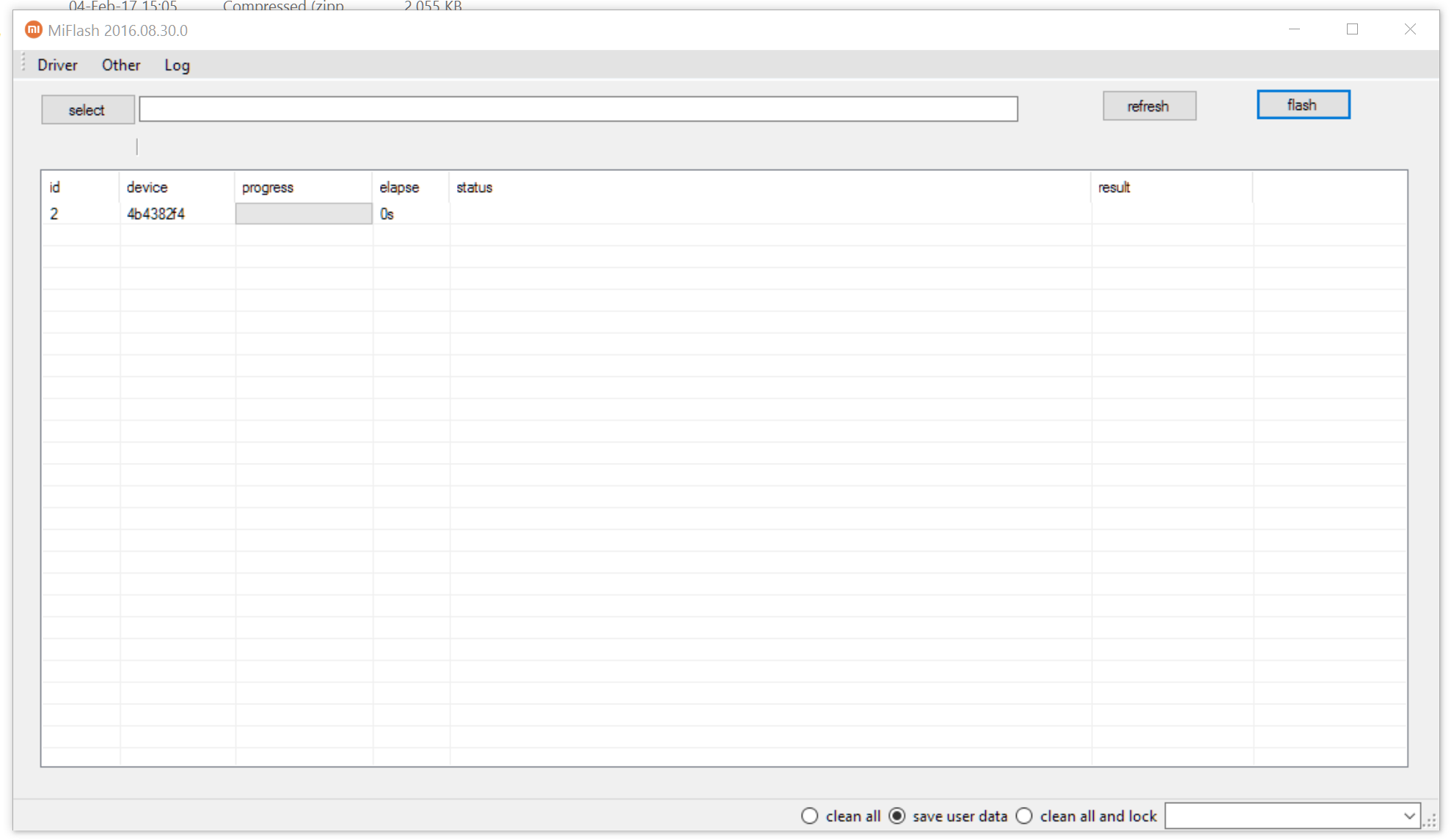

i used miflash app and after putting the phone in fastboot mode it is like this.
looks like miflash can see the phone. i am quite confused now...should i proceed with miflash for flashing an official rom? i dont want to brick the phone...

It looks okay to me.
As long as you are following Part 3 & make sure you have downloaded the correct ROM you will be fine.
