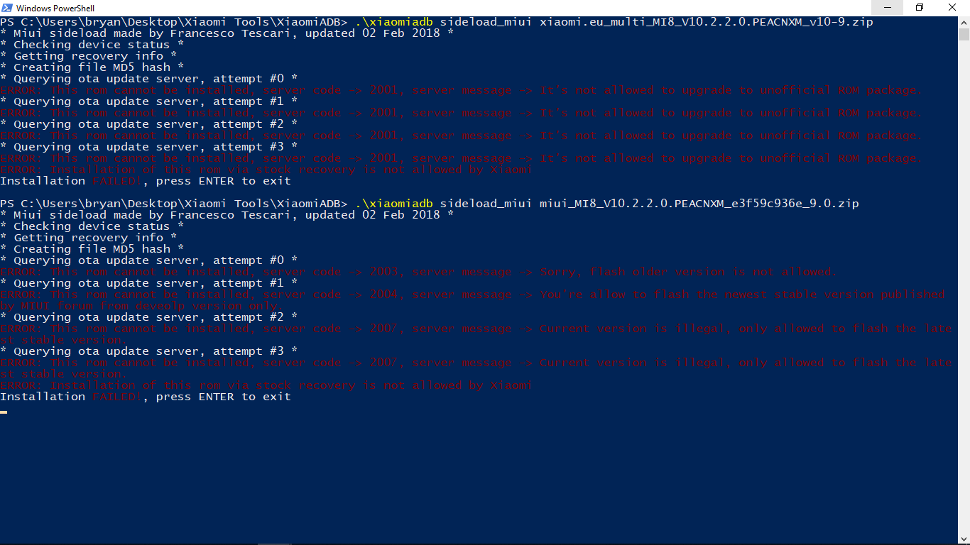

I have downloaded MiFlash and MiAssistant, which is the best means/method of getting a rom backbone the phone and getting up and running again?
So I have tried flashing a new ROM via XiaomiADB.
I've originally tried Original Chinese Rom as the handset was supplied from there with bootloader unlocked and flashed.
That failed.
So then tried the latest Global, and the tool completed, gives a successful message but then just boots back into MiRecovery 3.
I'm stumped at this point and any advice or assistance would be very much appreciated and needed ;)

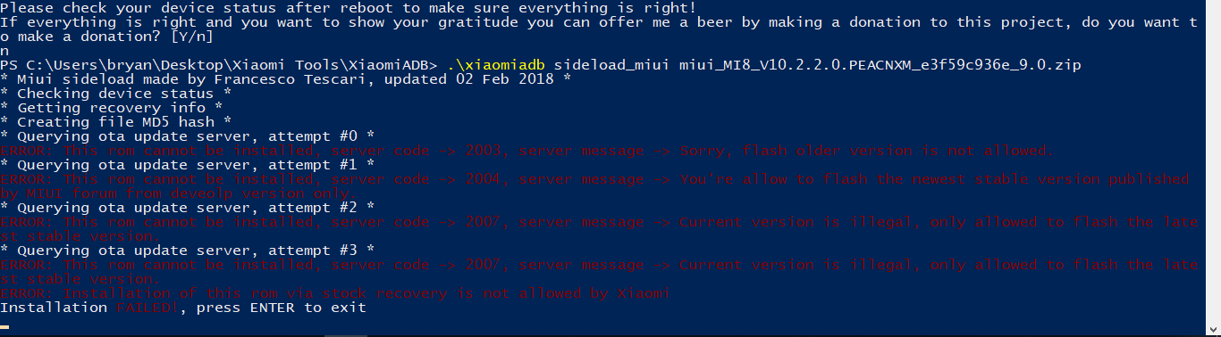

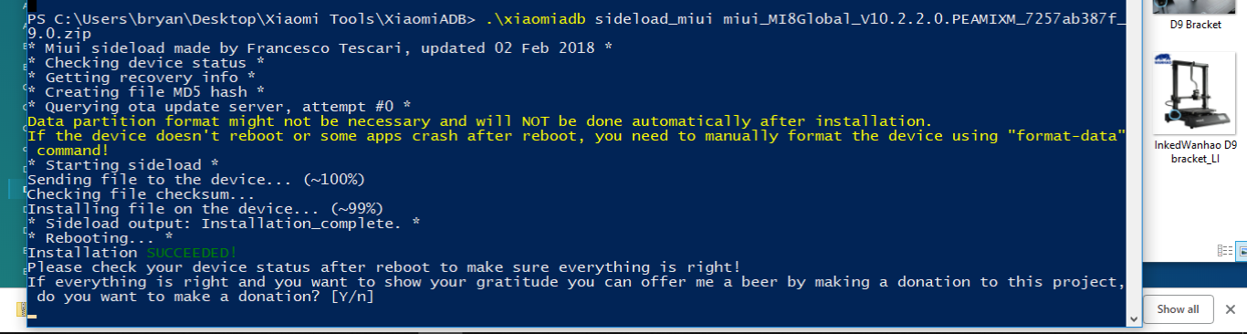

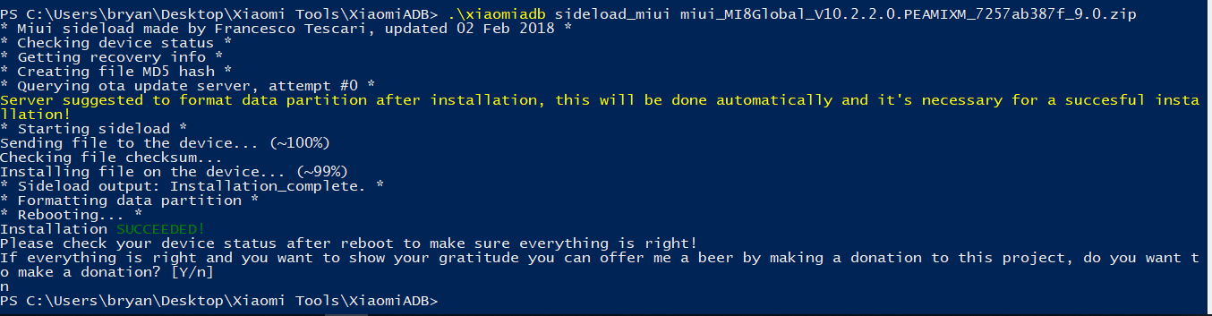

So I have attached 2 screenshots from XiaomiADB.
I can get the device to flash in this tool, the only image that will flash is the 10.2.2.0 Global.
The output confirms the server allows this image, and confirms a "successful" flash.
However when the Phone reboots it just loops back to MiRecovery.
I have also tried flashing the latest China Rom, but this fails out as not allowed by server.

I ended up flashing via EDL to get back to a Chinese ROM.
Just waiting on the bootloader to be unlocked now.
