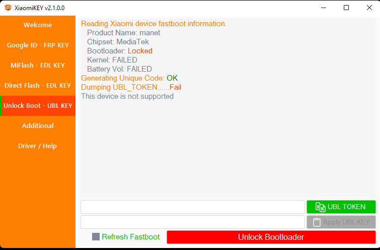

Yes, I have Redmi K70 Pro Chinese. No problem with XiaomiKey. I just prepared XiaomiKey app (v. 2.1.0.0) and go to UBL Token to generate token and it restarted adb to connect to fastboot. Can you go there and put your screen what the app display exactely?
Weird... I will keep trying then. Maybe my adb or drivers are not properly installed...
Are you sure you have Redmi K70 Pro? Your chipset is shown as MediaTek but it should be Qualcomm. You probably have Redmi K70E not Pro.
I mean, if that's the case I got scammed... But it did come in the pro box and says pro on the software? Lol
Edit: I also checked the IMEI

Maybe you should install the drivers again and make sure it is recognized by your PC. You can download fastboot and navigate to the path where fastboot.exe is located and type "fastboot devices". If that command works, then fastboot is working fine, and the unlocker from Xiaomikey uses fastboot so it should work too. Also, make sure that the phone is in fastboot mode when running the Xiaomikey software.

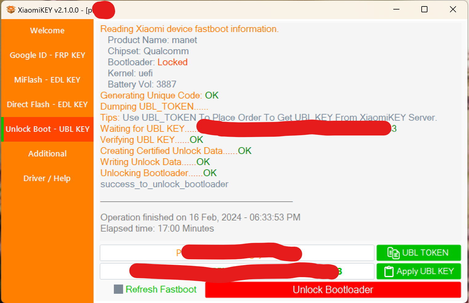

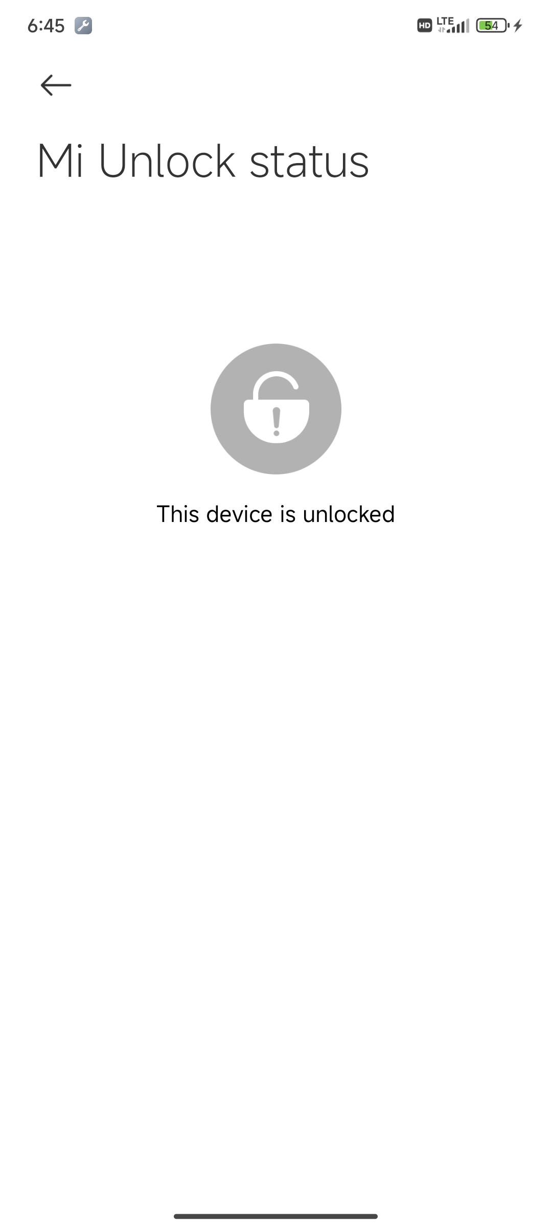

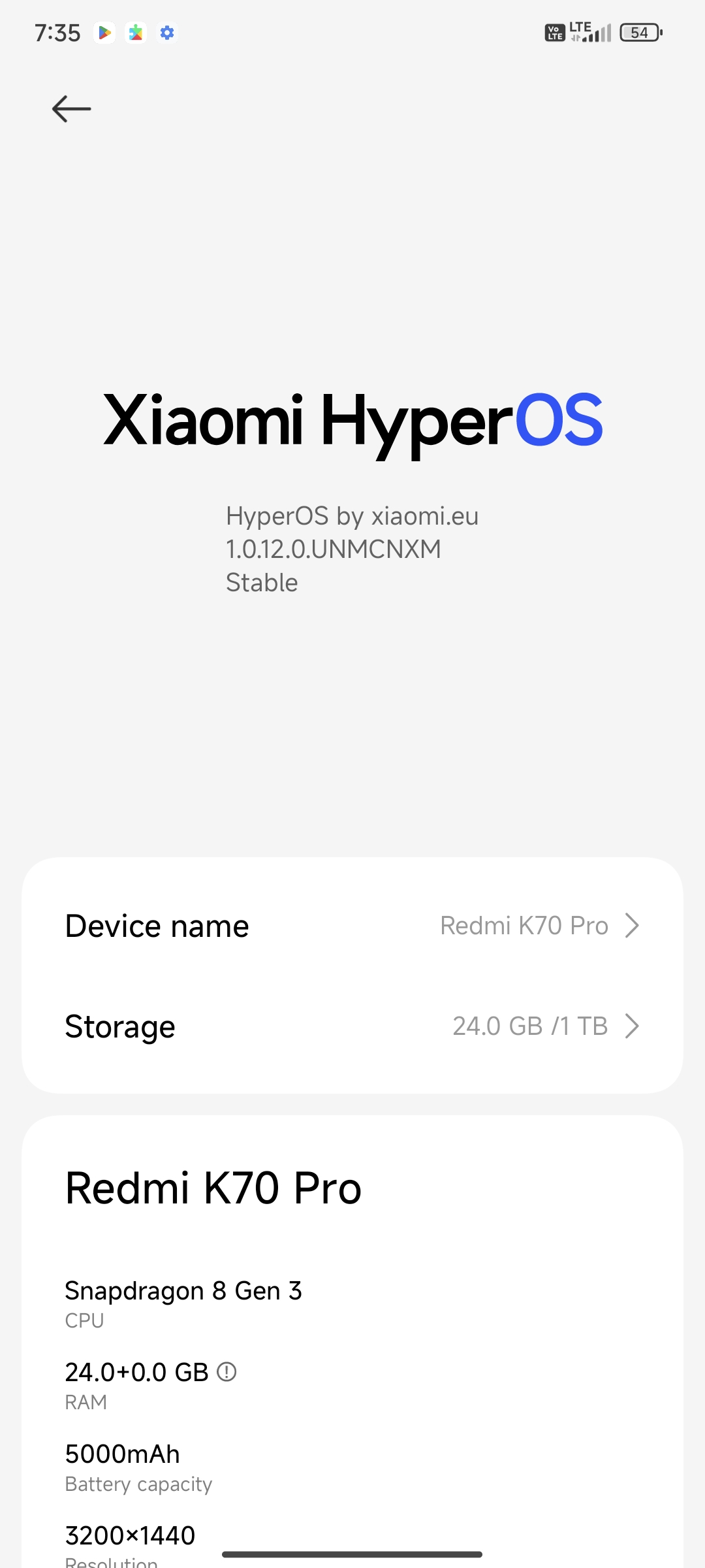

Sorry. I have been busy with work. Just got to this....
XiaomiKEY worked
I just tested it on my wife's laptop.
Idk what I did differently, maybe I was less dumb today and properly followed instructions. But it recognized my device.
I generated a UBL key, used the telegram bot and loaded funds.
Be aware, you have to pay with crypt0, I had to get a friend to help me because I got lost
I had to get help from `MikeyMaster` to have it approve manually since the crypt0 bridge or whatever took a random fee.
Once the funds were loaded, it allowed me to buy a UBL key. I put that UBL key in the program and it wiped my device and unlocked it.
I can help with questions about the process. But not with payment. My friend had ethereum and bridged to bnb and then bridged to tron and sent USDT.
And flash was successful!
