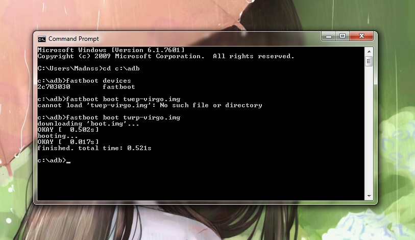

Secondly, in command promt, locate to the directory you put the folder adb/. Use the command "cd". Here is an example where i put my folder unziped in Download\ :
Code:
cd c:\users\myusername\Downloads\adb
Next, after you move twrp-virgo inside adb\ folder, do fastboot devices to check if your smartphone is detected, and fastboot push xxxx :

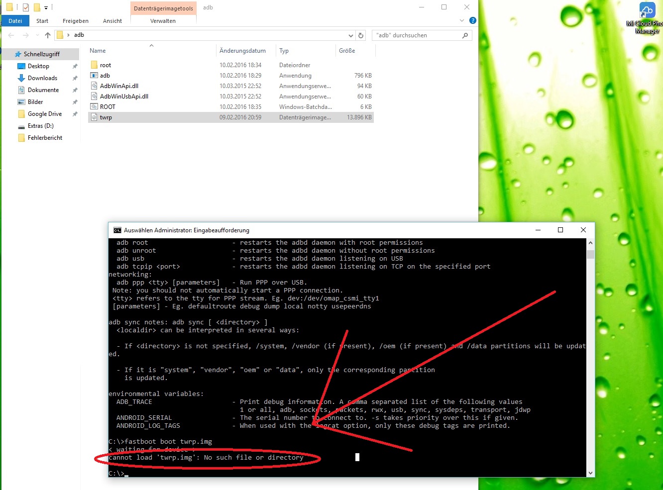

My Note didn't boot the twrp image at all, don't know why, everything looks okay in the Command Prompt...
