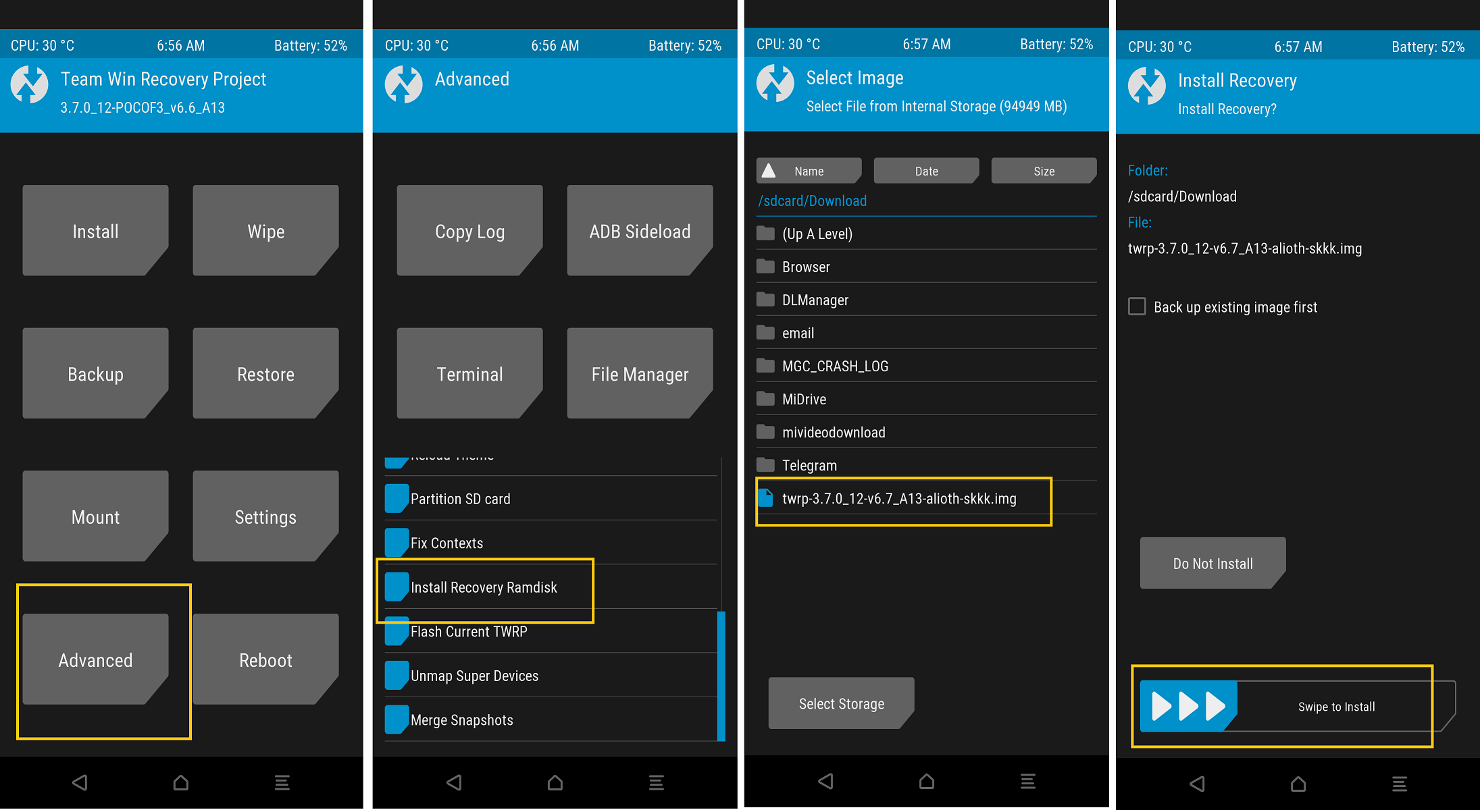

is it possible to update the twrp skkk to the latest version, directly from recovery?
Yes.
- install Recovery Ramdisk
- reboot / recovery
