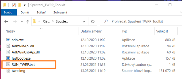

5 - -Connect your phone to your computer in fastboot mode
6 - Start TWRP using the Fastboot toolkit
TWRP_toolkit
Unzip the downloaded toolkit and run it by clicking RUN_TWRP.bat

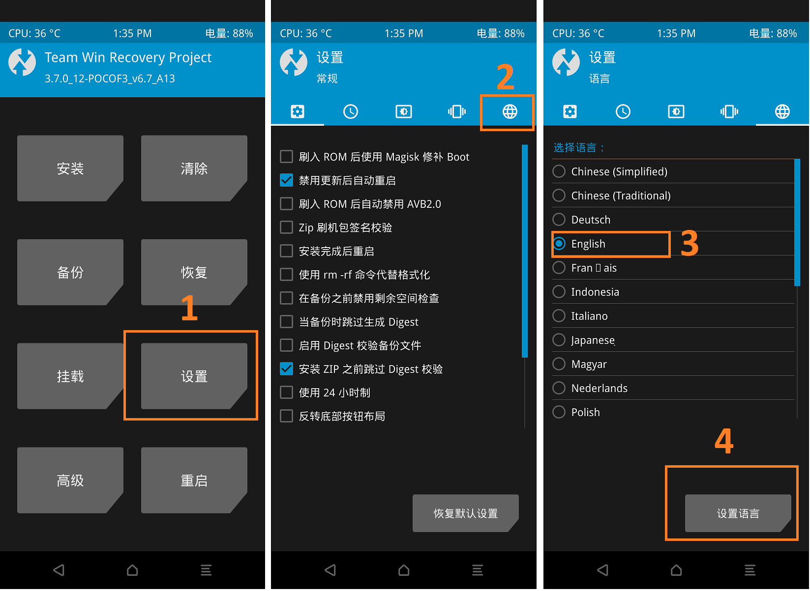

To change TWRP language to English,

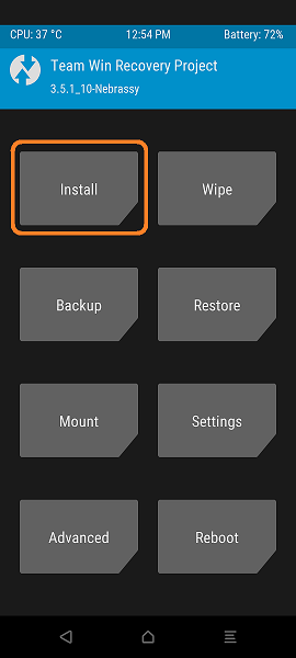

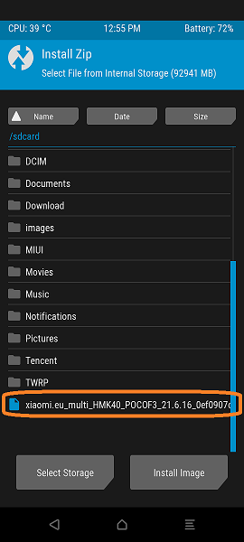

8 -Install ROM
card / Install
37956
find the required ROM in the repository
37957

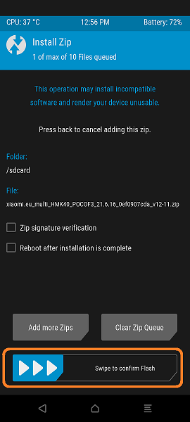

start the installation - swipe to confirm Flash

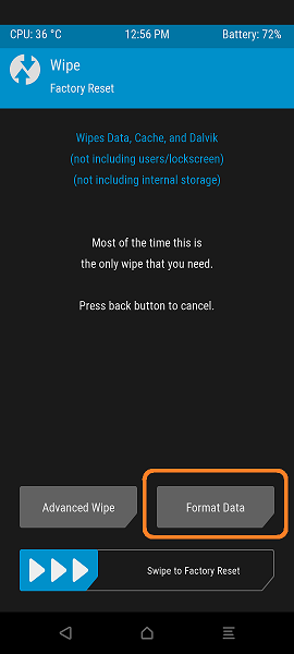

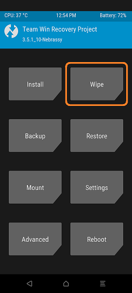

- Format Data
card / wipe
37959
Format Data
37960
Confirm the format by entering - YES
37961
restarts the system after formatting is complete

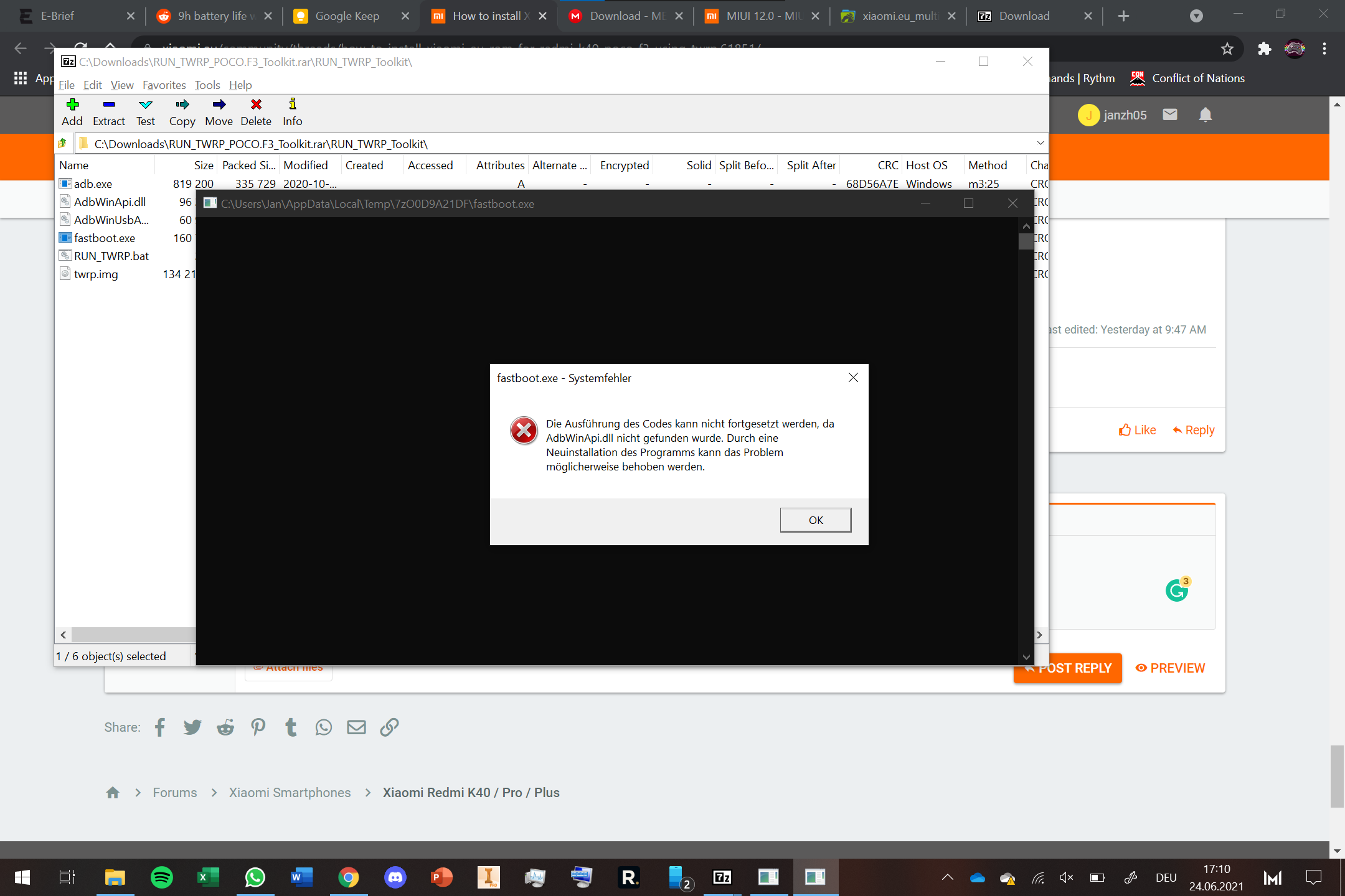

@janzh05 Hello, you have to extract the archive (and not open fastboot.exe in the archive directly). ;)
Then you can run "RUN_TWRP.bat" from the extracted files. :)
And how exactly do i do this this is my first xiaomi/poco phone and first time flashing anything. I already found the right Rom and have still to wait 1 day till unlock but could u like give me a step by step instruction on how I do this and help me with this. Thanks.
  • With 7-Zip: Right-click on the downloaded file (RUN_TWRP_POCO.F3_Toolkit.rar) => 7-Zip => Extract here
- OR -
  • With WinRAR: Right-click on the downloaded file (RUN_TWRP_POCO.F3_Toolkit.rar) => WinRAR => Extract here
Then, open "RUN_TWRP_Toolkit" folder (next to the downloaded file, in Windows Explorer) and run "RUN_TWRP.bat".

Procedure is to go in "Install" menu then find the ROM (zip file) and install it.
Reboot your device when it's done.
That's all! You keep your data of course.
