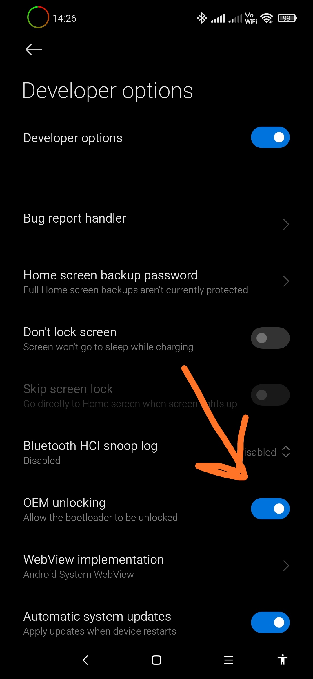

How to check if my bootloader is unlocked
Under Setting - Additional settings - Developer options i dont see Mi Unlock status. I am little bit confused now.
Here it is on mine, see attached screenshot.
