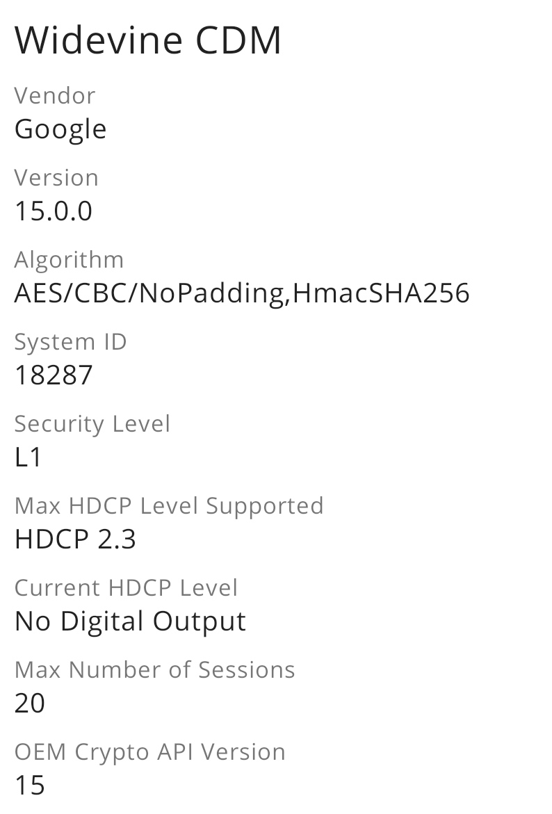

Do you still have Widevine L1 after flashing? I received my ultra today and to my surprise it passed safetynet and has L1 widevine out of the box. I still want to use xiaomi.eu but only if I don't lose Widevine L1.
Yes, Widevine L1 is still present in the EU Rom.
