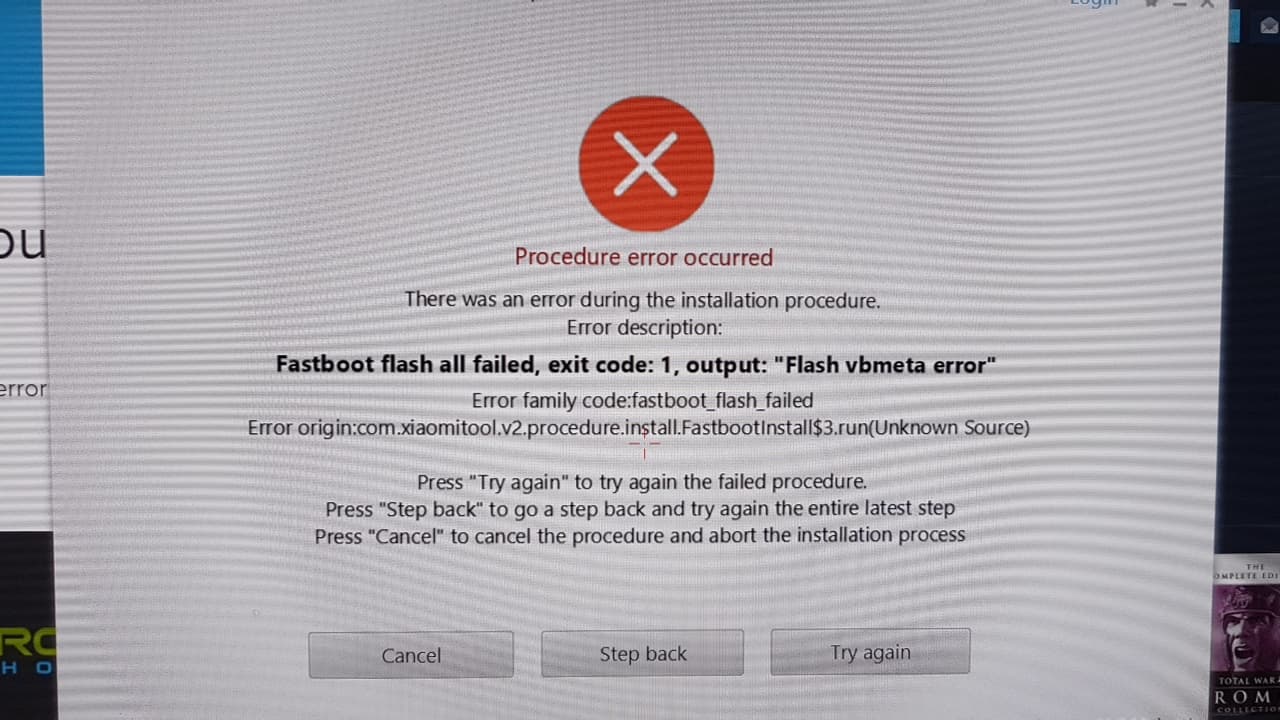

I tried to reset my phone with the xiaomi mi tool v2 but with no success, I get this error message
