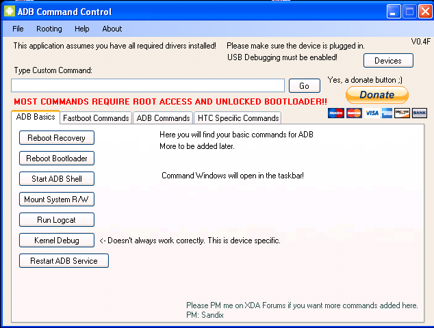

@SairS I followed the steps you mentioned, but as u said im struck in step3. i have tried several times and its just not possible to detect the device and install the driver.
The MTK device appears in the device manager few seconds and disappear. Even if i somehow manage to click this in this 2 seconds and install, the files gets copied but when i use the MKTdroid tool, it doesnt detect the device. I m sorry mate. Need your help. I googled prlenty of option and nothing worked. Even i tried the ADBdrive installer and it worked but when i open MKTdroid tool, it doesnt show the device.
I even tied in 2 different PC( one XP and other win7), same result.
What to do now?
Looks like ADBdriver installation worked perfectly. The next step is i have ADB command control. But i have no idea what to do. May be you can help me.
Which one you downloaded. Now there is no need for ADB tool, use the MTK Droid tools..
Do these steps.
1) Keep device manager open on the computer. Unplug the phone from PC if u connected.
2) Switch off the phone remove battery.
3) Now connect ur phone to computer , ur computer should say driver installing .
4) Now see in device manager under other devices. Click on it u will see this s**t phone and update the driver.
5) Once done reboot the phone connect to computer.
6) If usb debussingmode is on, you should see android phone in device manager .
Let me know or lets leave it and fight with aliexpress. I escalated the dispute..
