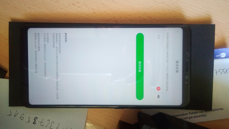

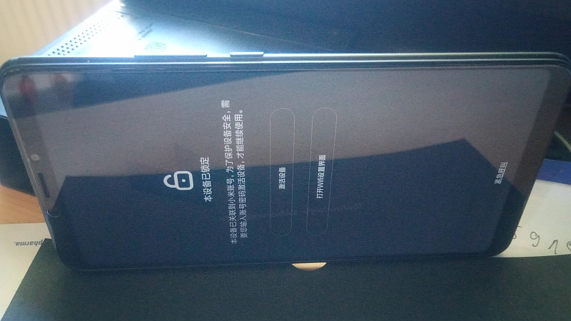

I am in trouble. I got the Mi Max 3 with 128gb and the global fake rom. I just flash the phone with miflash and rom here provided. I follow the instructions and flash reportet successfully. After reboot i can do absolute nothing. See the pics. Its dead now ?

Your phone is bricked!
Your Mi Account is blocked.
It's dead unless you get Xiaomi China service centre to unbricked for you!
