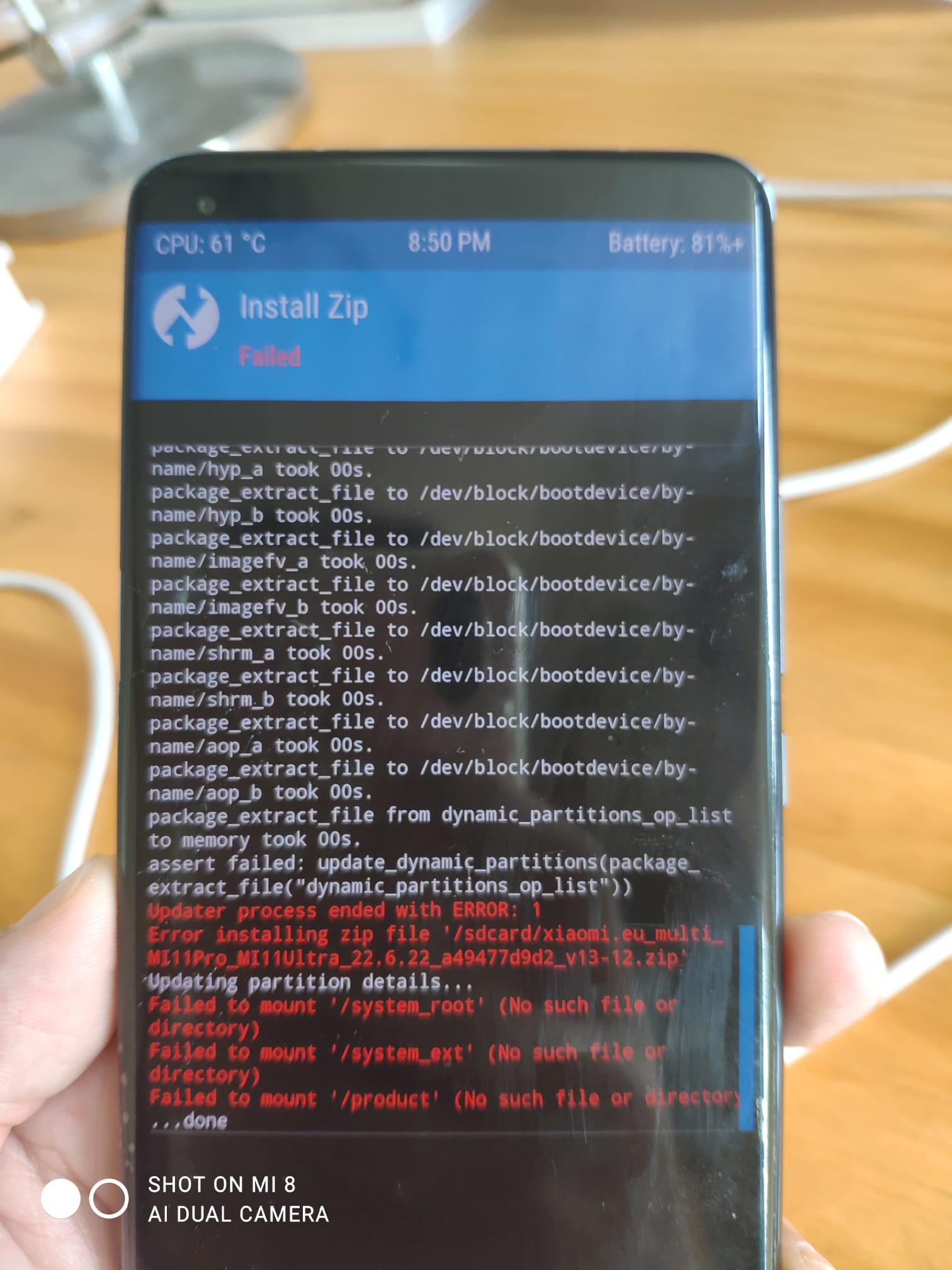

I have problem updating the ROM with the error message show in the image.
My Device is Mi 11 Pro
boot with fastboot boot twrp.img
I tried both Pattern and Passcode to unlock the device, still show the same error message when I try to update the ROM.
What I have done wrong? Thank you very much.

try to install TWRP first then reboot again to TWRP to install rom.

1) fastboot boot twrp.img
2) Install TWRP
3) do we need to wipe any partitions? I think i had to when i installed twrp for android 10/11
backup everything so we don't lose data?
4) Download ROM.zip into root directory
5) Reboot into TWRP
6) Install ROM
Instructions for A/B equipment ( All devices before Mi 11 era (except Mi 10S, Redmi Note 10 Pro Global iirc) are non-AB).
Updates via TWRP:
- Insert the ROM into the phone.
1. Download TWRP to PC and rename it to twrp.img https://dl.akr-developers.com/?dir=skkk/TWRP/A12/v3.7_A12
2. Run TWRP fastboot command
Code:
3. Install ROM
4. Reboot system
