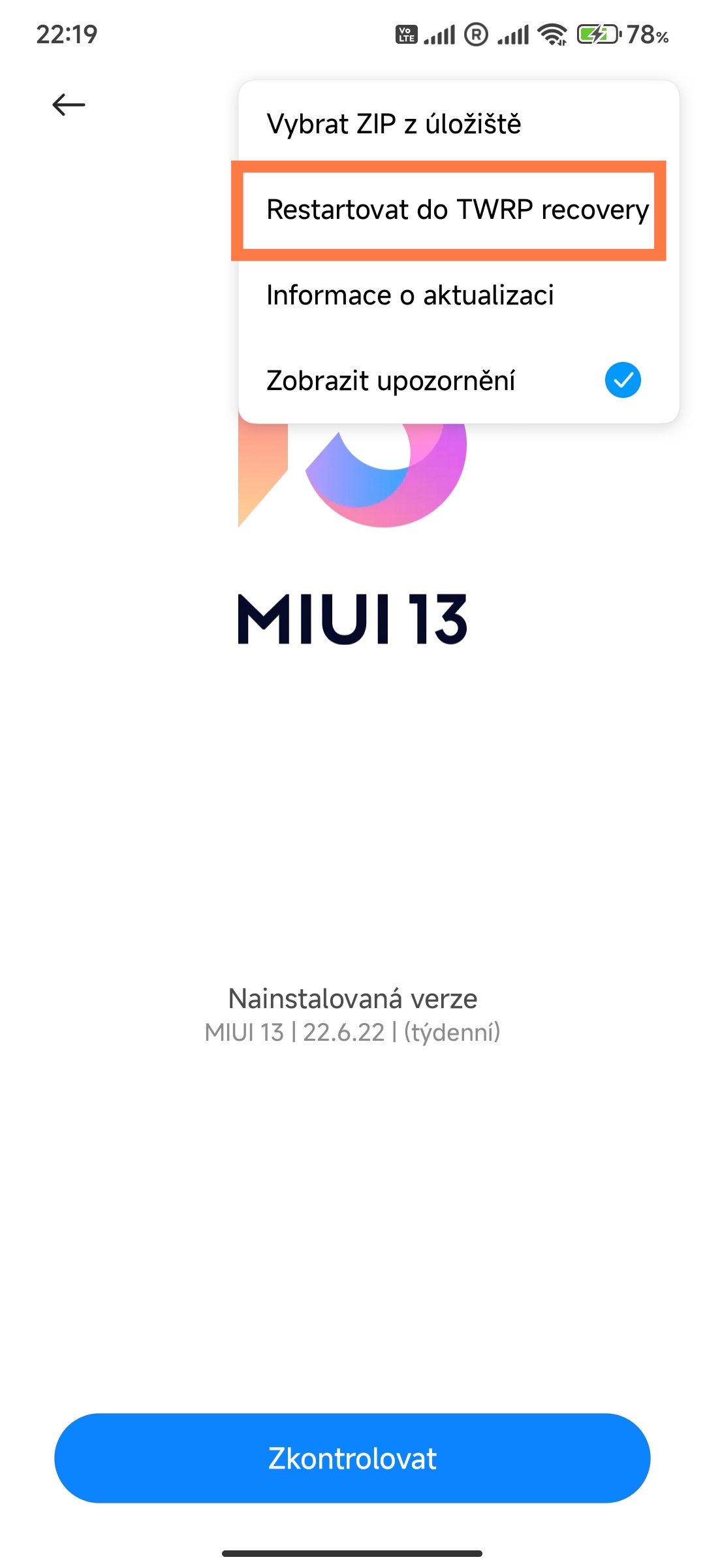

Get Message waiting for device. Ultra is in fastboot Mode nothing happens
Need the Update app.
Or - power and volume +
