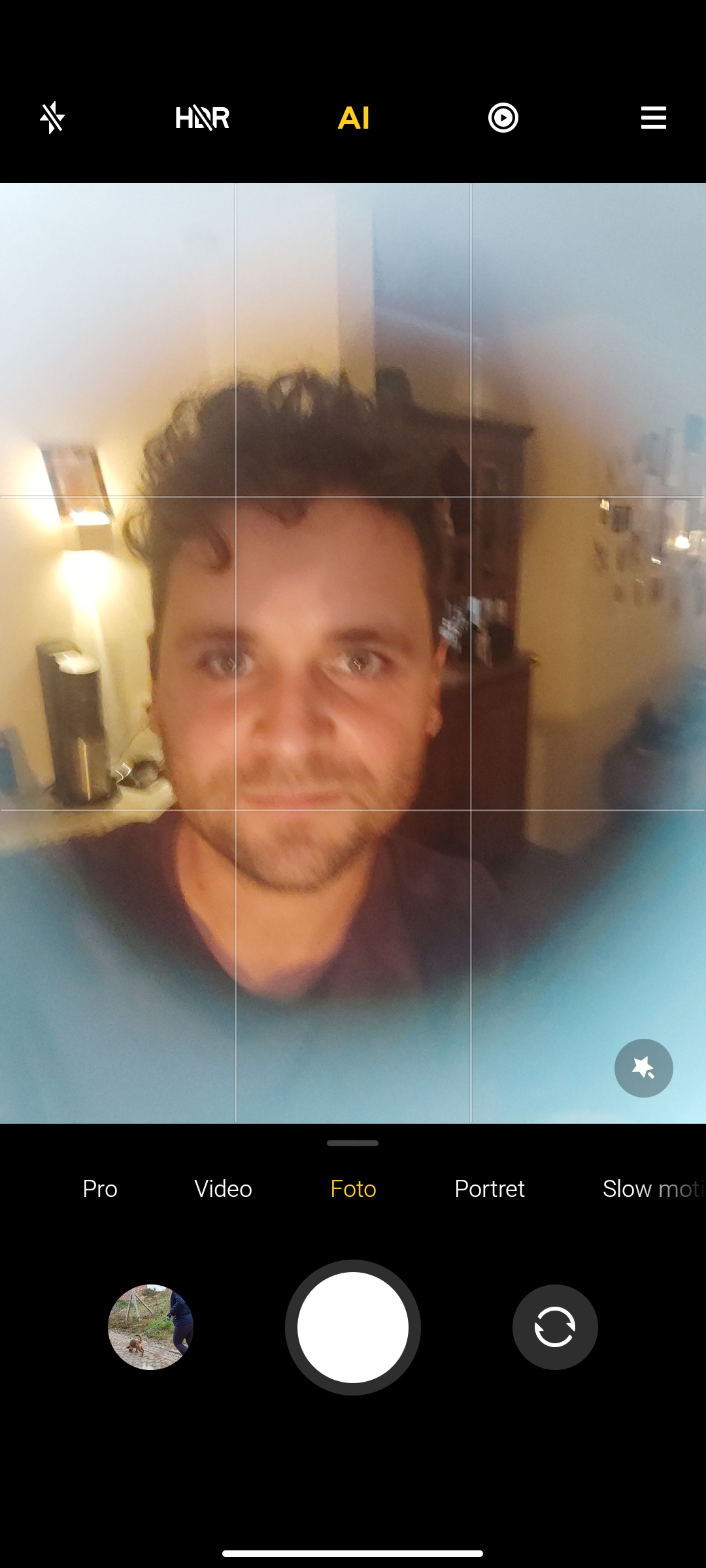

The latest Android 12 beta always displays a white ring around the selfie camera when it's active (for security reasons?). The ring is too close to the camera which results in pictures that have a strange halo around them, it looks like an ugly filter.
I've added a screenshot what it looks like, however the white ring around the camera isn't visible in the screenshot.
(Picture was taken with a Poco F3/Redmi K40)
