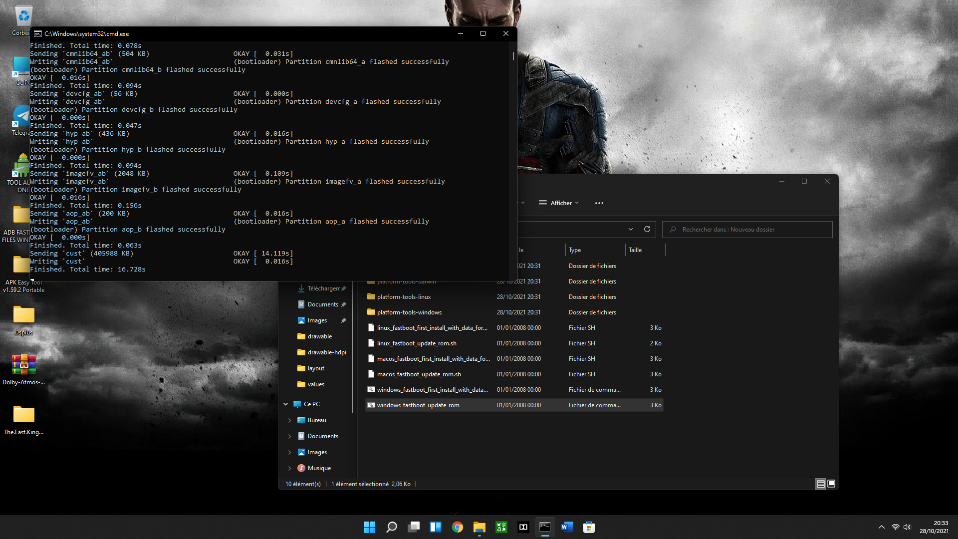

Dirty flash ok but still the update indication available... ;)
