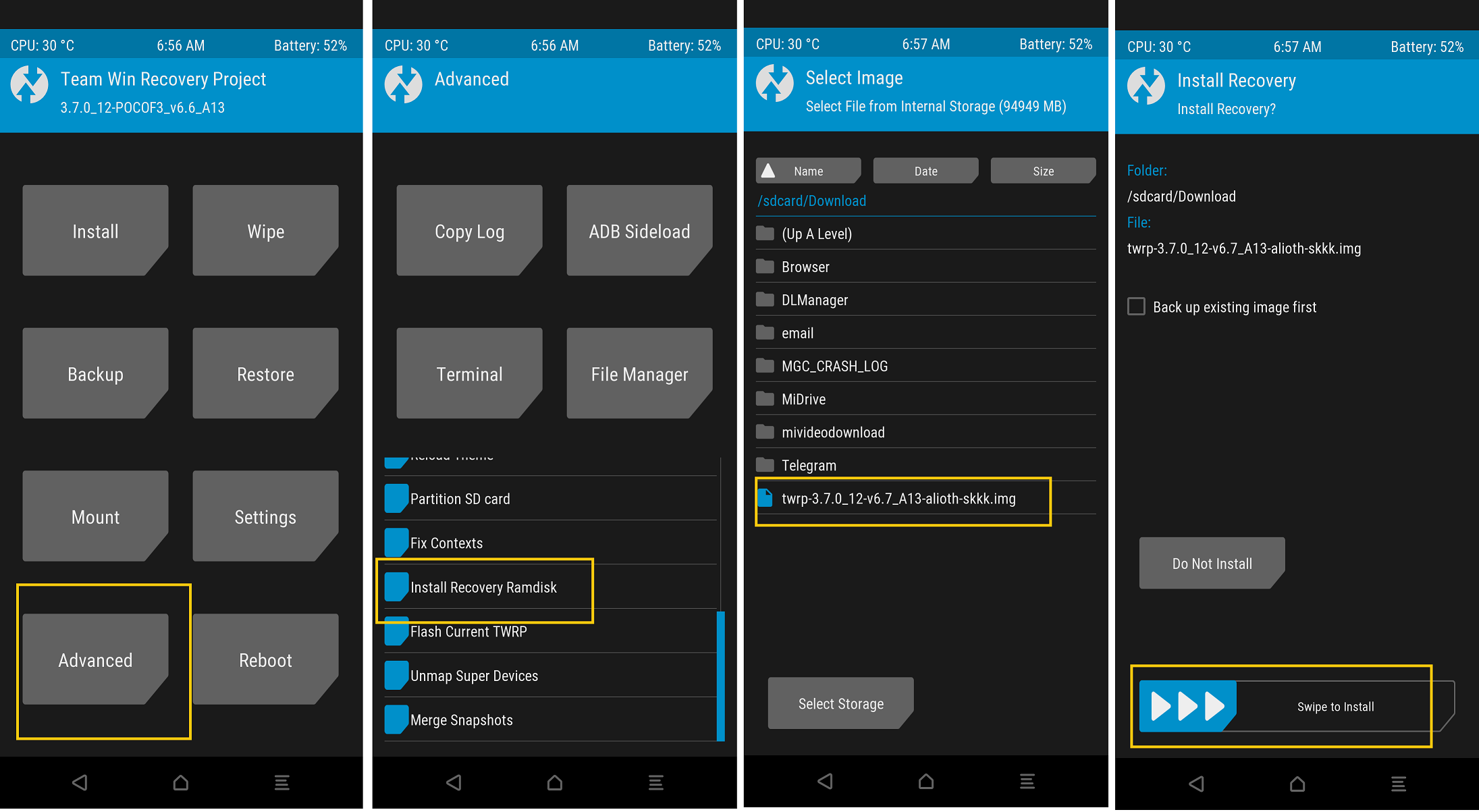

i use this

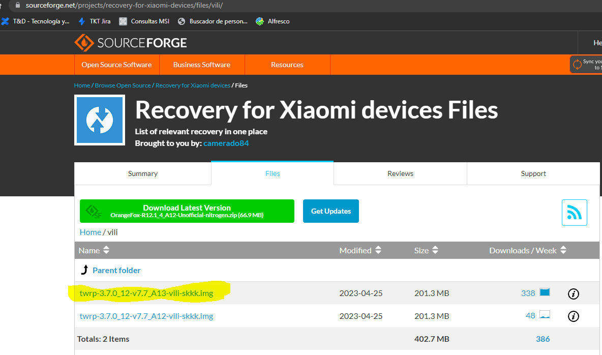

Don't use TWRP for android 13 if you have old android 12 or earlier ROM on your device.
How to install TWRP on Ramdisk.

I've tried to write twrp-3.7.0_12-v7.7_A13-vili-skkk.img from fastboot but it is not working for me.
Do you have any sugestions?
Have a nice day!
Guys, i've redownloaded both twrp and adb/fastboot and it worked.
