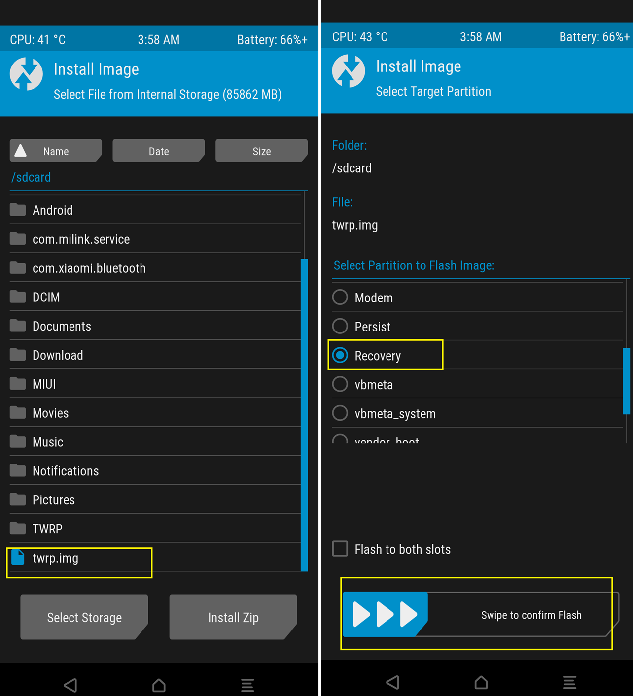

do not touch the slot
Select image-->select the. Img-->recovery-->reboot to recovery

It worked ! Thanks guys.
Maybe could you explain me the difference between:
- Recovery Ramdisk
- Recovery
- Flash both slot or only one
Thanks for your answer.
You have a device with dedicated recovery partitions (A/B), therefore you have to choose recovery.
For devices with boot as recovery (A/B), there is no dedicated partition for recovery. In this case you have to choose recovery ramdisk.
