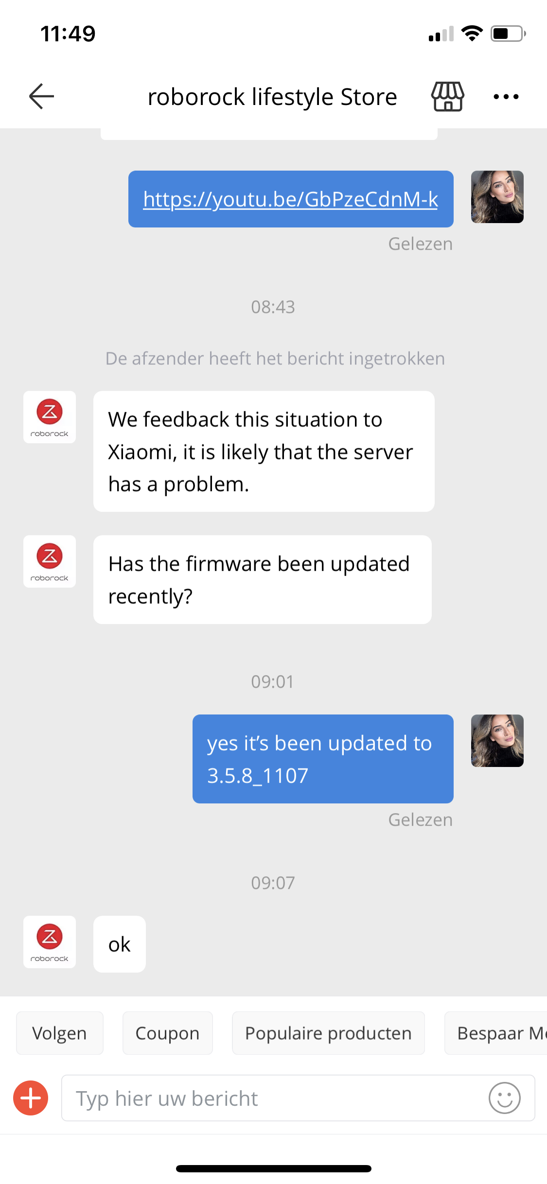

Anyone who reported this to the local vendor?
Any feedback yet?
I spoke to UK customer service aboit it. They did not help at all. They only said they can not accept it for repair as they don't have spare part for it. Absolutely disgusting. Only used it for a month. What a waste of money.

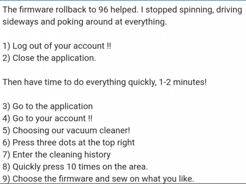

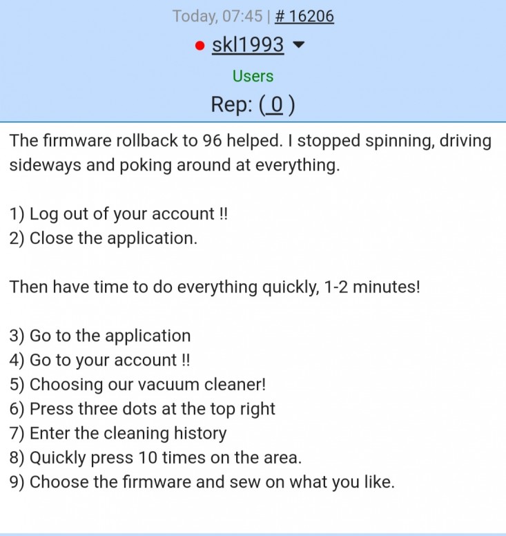

Hi! today update the firmware version to version 4.1.8_1113 and now it's working really good!
I hope it works for you!
Follow this instructions and update to version 4.1.8_1113:
37939
Upgraded my Xiaomi Vacuum C1 to 3.5.8_1107. Big mistake, it is going randomly, going backwards and trying to climb the wall/furniture/etc and also makes a lot of noise when trying to climb everything. Big disaster with this upgrade, looks like it wasn't tested at all by their testers.
I managed to upgrade to a different version, following the steps from above. To upgrade, you will need to tap rapidly exactly on Total area multiple times, until information about your robot cleaner will be displayed and from there you can upgrade to different versions. Beware, but sure if those versions were tested at all, I personally upgraded to 4.1.8_1114 but I haven't a change to see if it's working ok now.

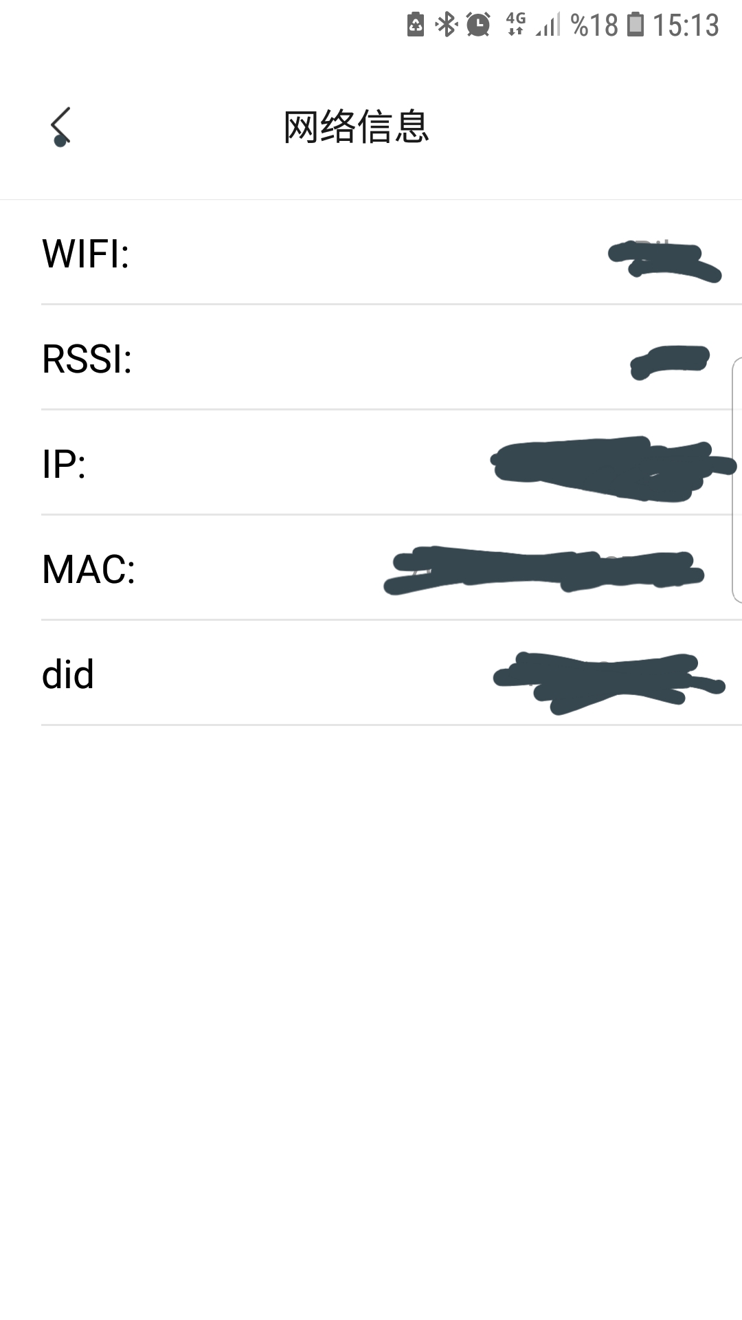

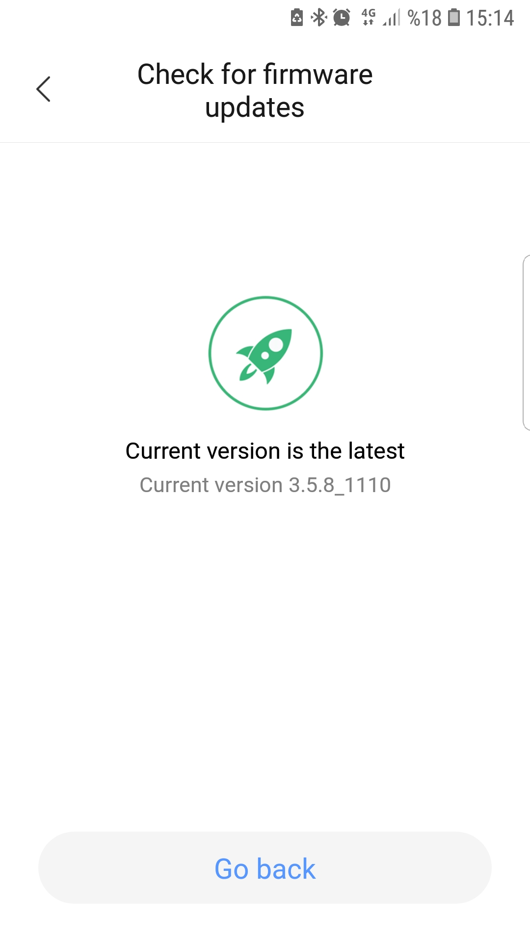

I'm having same issue about rolling , spinning, doing stupid bacward move with tire locking and most importantly when i send area cleaning its finish cleaning after couple seconds without cleaning. This all happened after update now my version 3.5.8._1110 and couldnt manage to roolback when i tapped cleaning area it only shows my ip and info nothing related with fw update. Please help me about rollback the firmware im waiting for new Update like for a month seems no one giving s..t about it...
