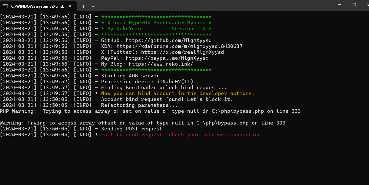

Same on Poco X5 Pro 5G :( ...any help?
Any thoughts?
Same problem on redmi k60 - 'Request parameter error (10000)' ... Did some one get solution for this problem?
