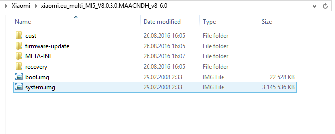

I think the ROM is incomplete because there is no .bat files into it - see attached screenshot!
I did something wrong?

Did you even read instructions? You have to use twrp to flash Xiaomi.eu ROMs.
