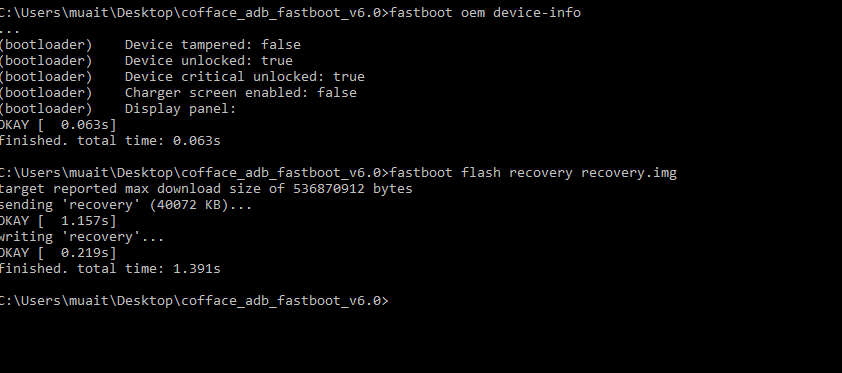

I have a little problem,can't flash twrp recovery.Bootloader seems to be unlocked but i have any recovery access.Unlocker says Could'n verify device - No need to unlock this device
I don't know if now there is a brick possibility if i try with miflash mode
I had same problem... I changed USB port to connect MI 5 to pc... After that all work fine

It's a strange issue not related to pc flash .Tested on 3 different pc but stil no recovery access.Bootloader seems to be unlocked and recovery seems to be flashed but MI5 is a mistake thing...NO Recovery access
Do you use the right miflah 64bit?
