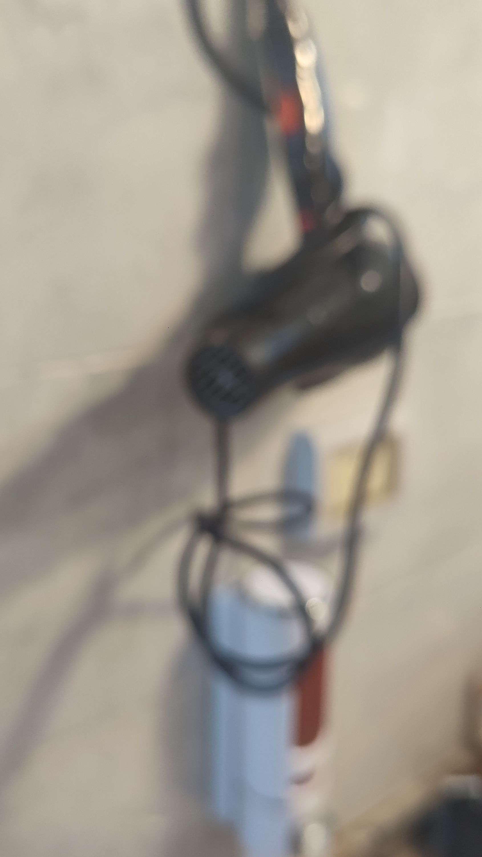

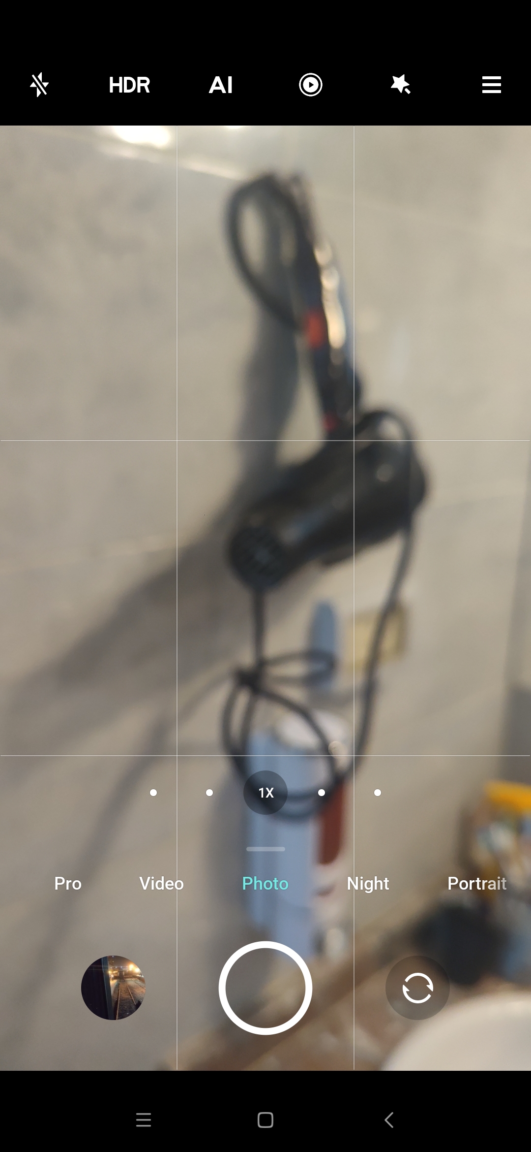

On my Xiaomi Mi 10 Ultra my camera (main) have blurred image all the time. i tried to change app, install firmware again(12.5.6), but nothing is solving it. - camera was working fine for a year with same Rom version-
I think something is wrong with the camera but dont know if it is software issue ou hardware.

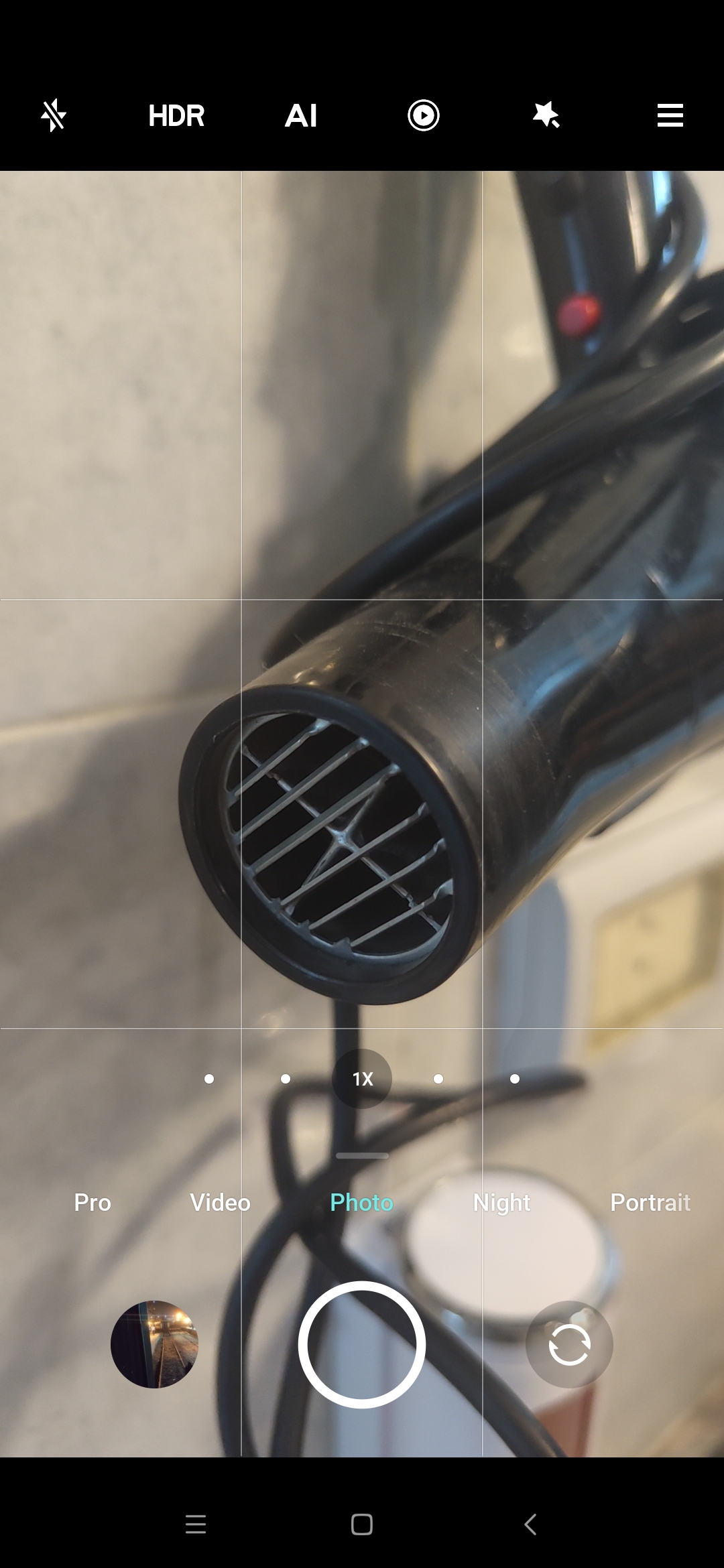

When i put phone near an object (less than 10cm) the picture is clear. but when i step forward (more than 10 cm) it's become blurred (screenshot attached)

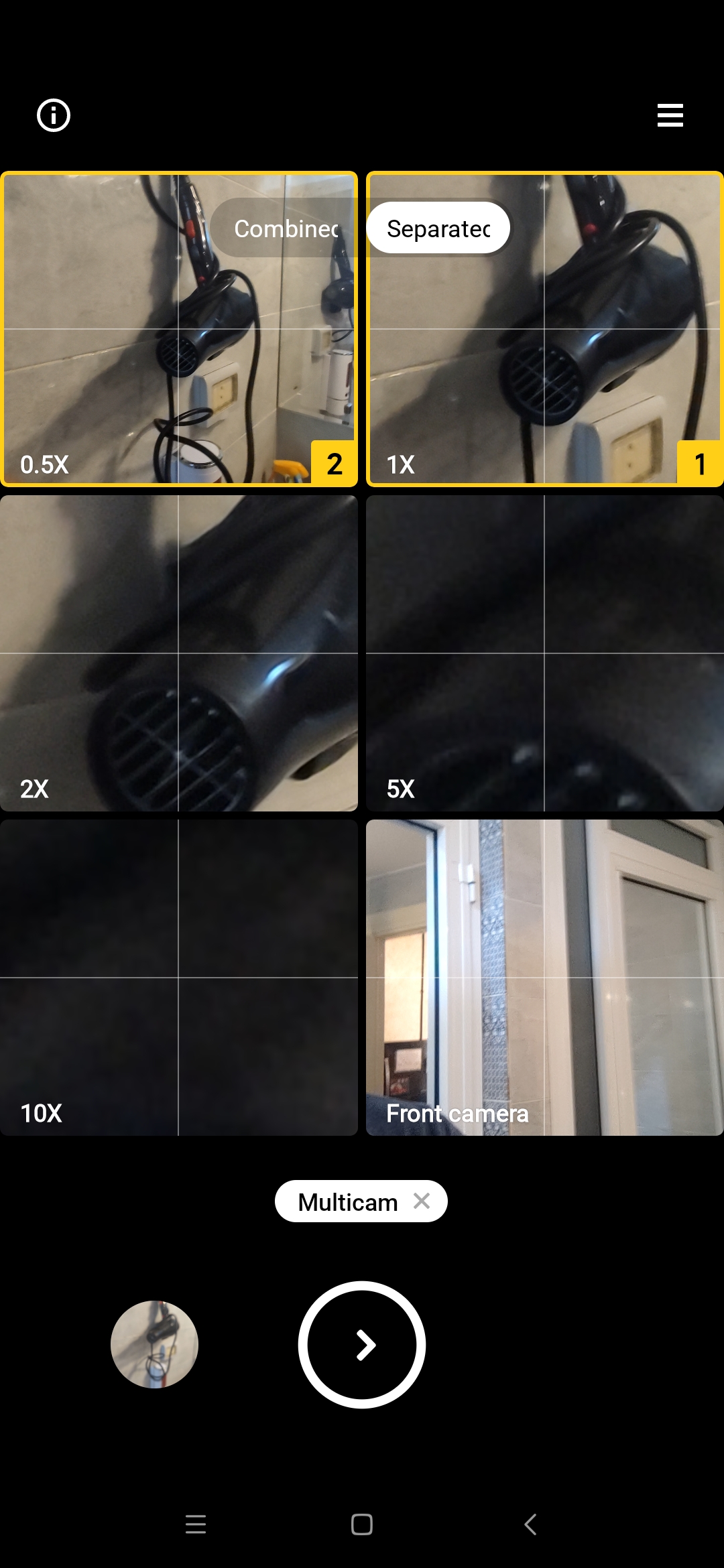

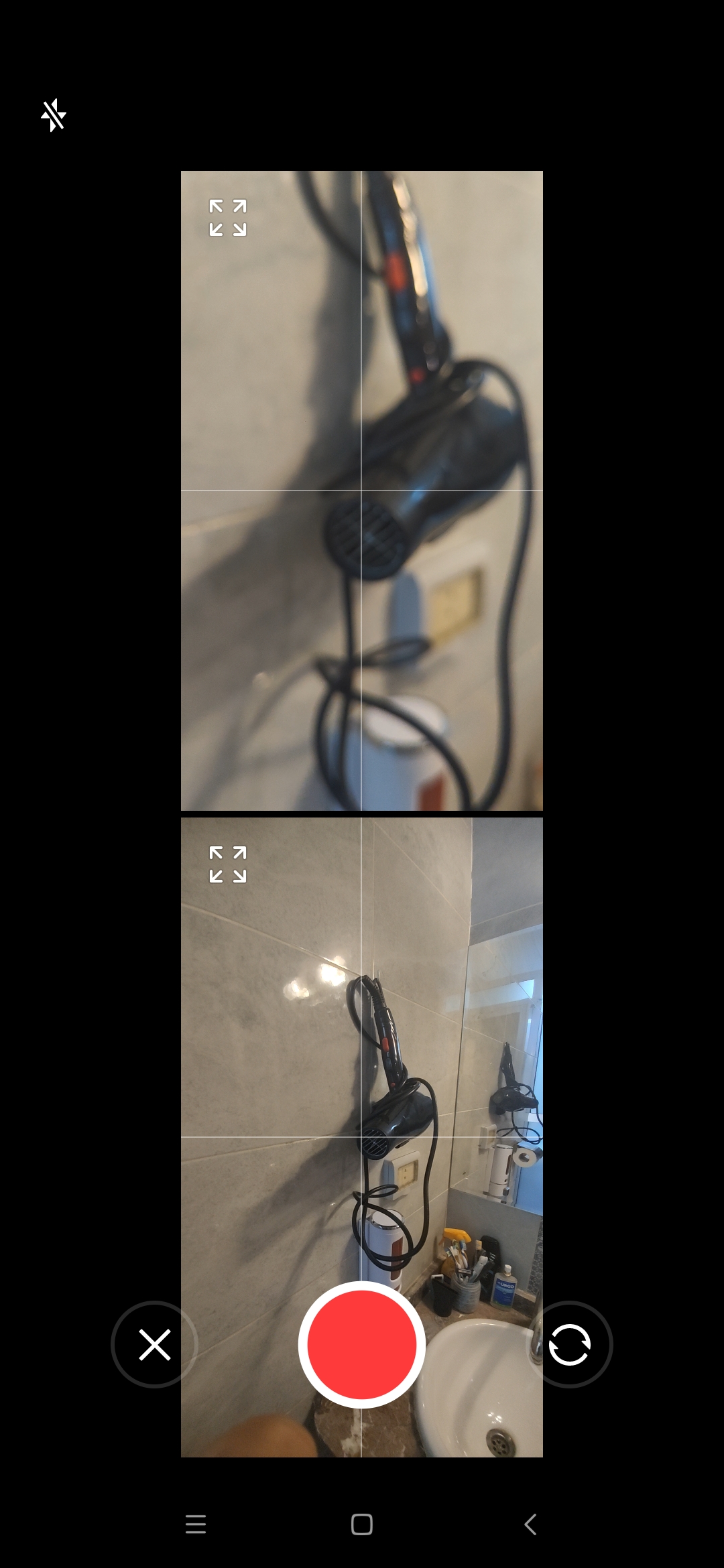

the only moment i can see its still working its when i use multicam mode (in screen selection) i can see that the image is clear (screenshot attached)
can someone help me to understand the issue and if its Hardware related please?

Its same even when i tried *no-support-for-this-app-on-this-forum*, opencam and all other apps using manual focus
To rule out software, you could try installing stock rom again, see if the camera works, if yes, install xiaomi.eu again and see what happens. If not, focusing mechanism could be damaged, it happened to me once many years ago on mi4s, no matter what I tried, it refused to focus, changed the camera module, everything worked again.
Reactions: Ryskle
that what i was thinking, any file to flash without installing stock rom ? im traveling and can't do that and loose data
