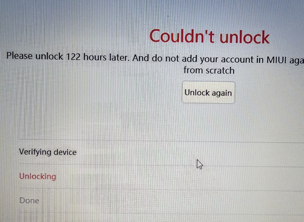

Hi All,
I bought Chinese version of Xiaomi 13 and asked for booloader to be unlocked for almost a week now and the tool keep saying can't unlock.
Should I flash the global fastboot rom using mi flashtool or what? I don't remember it takes that long to unlock bootloader :(
I just want to use eu rom

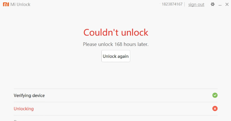

The number of hours remaining should be shown in the unlock tool, the usual unlock time is 168 hours - which is 7 full days.... so "almost a week" is apparently too short ;)
Oh, and you cannot flash any other ROM with the bootloader locked !

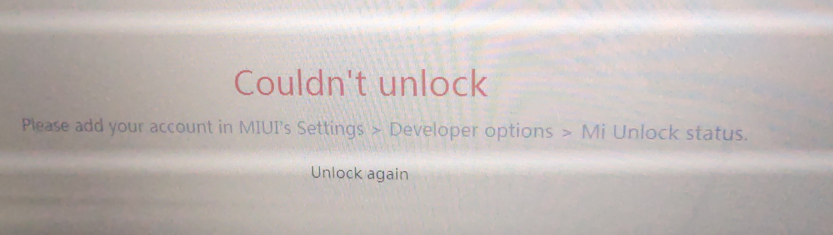

Can't see remaining hours though. I already added the phone to the account :confused:
Hmmm, that looks strange - I need to check with my device and the unlock tool later at home to see how the windows looks like here ....
I logged-in using my Xiaomi account, enable usb-debugging, enabled OEM unlocking and added the device to my account (now it shows under "my devices").
then used the tool to unlock. tomorrow will be the 7th day so hopefully will be unlock-able by then
I think what @deepblue2000 is aiming at is that there is another menu entry under developer options titled "MI unlock status" where you need to activate the unlock device-side before doing so PC/server side with the PC tool.... this is additional to "OEM unlocking" you mentioned, but maybe this is what you mean by "adding the device to your account"....
When I did that for my 13U two days ago it concluded with a green checkmark and the number of hours remaining (168), as written above I'll check later the day and report how it looks like now....

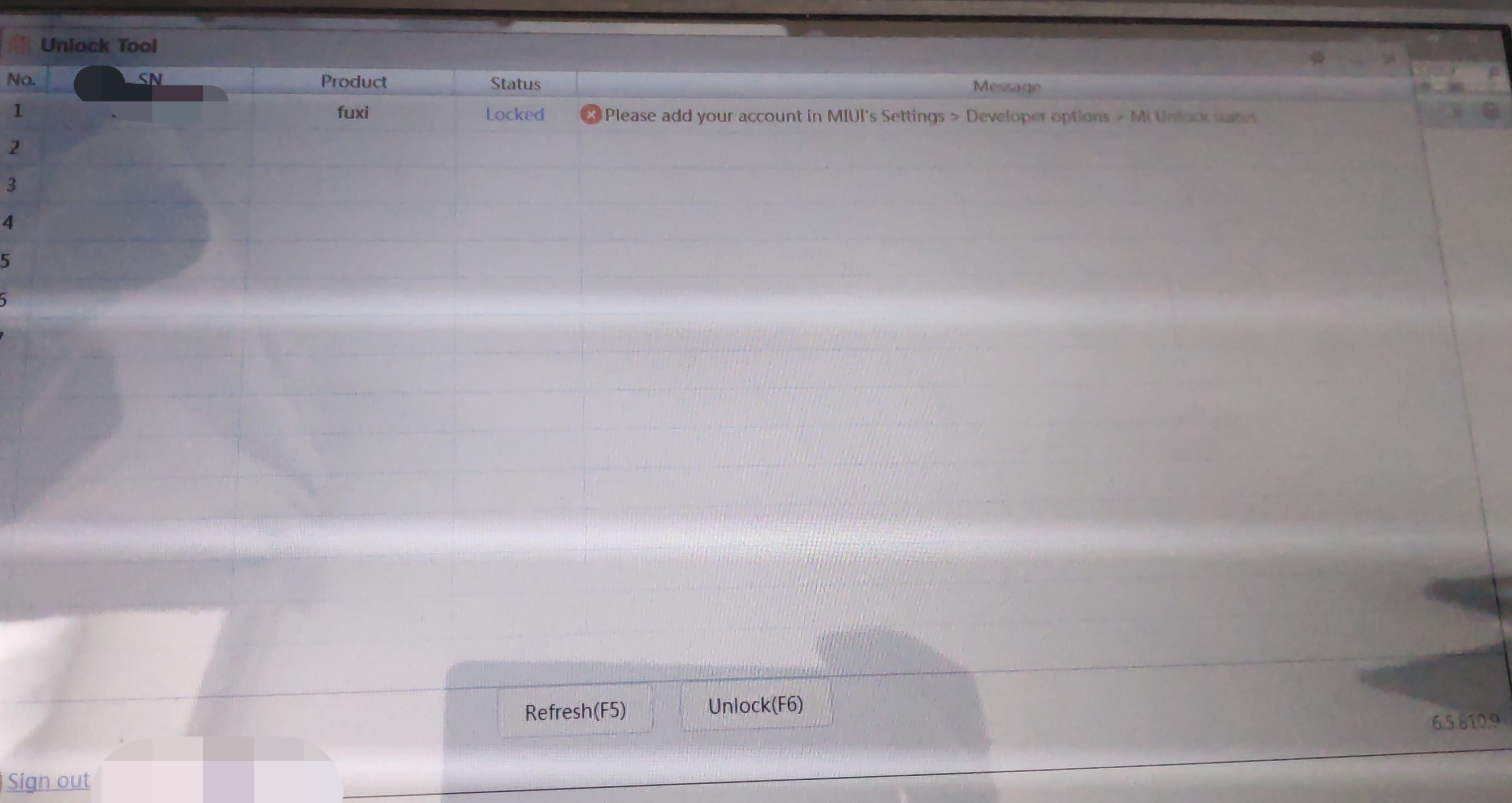

I found another tool that would tell how many hours left.
However, still getting the same message :(
It seems you made a mistake in the bootloader unlocking process. If you have not been given a time, it means that the unlocking process has not started.

Just checked here, i get shown the remaining hours with the official unlock tool.....
I would suggest you missed the step I pointed out above....

Both tools i tried still showing the same message :emoji_sob:
The only thing i can think of is it would take some time to start the unlock process?
