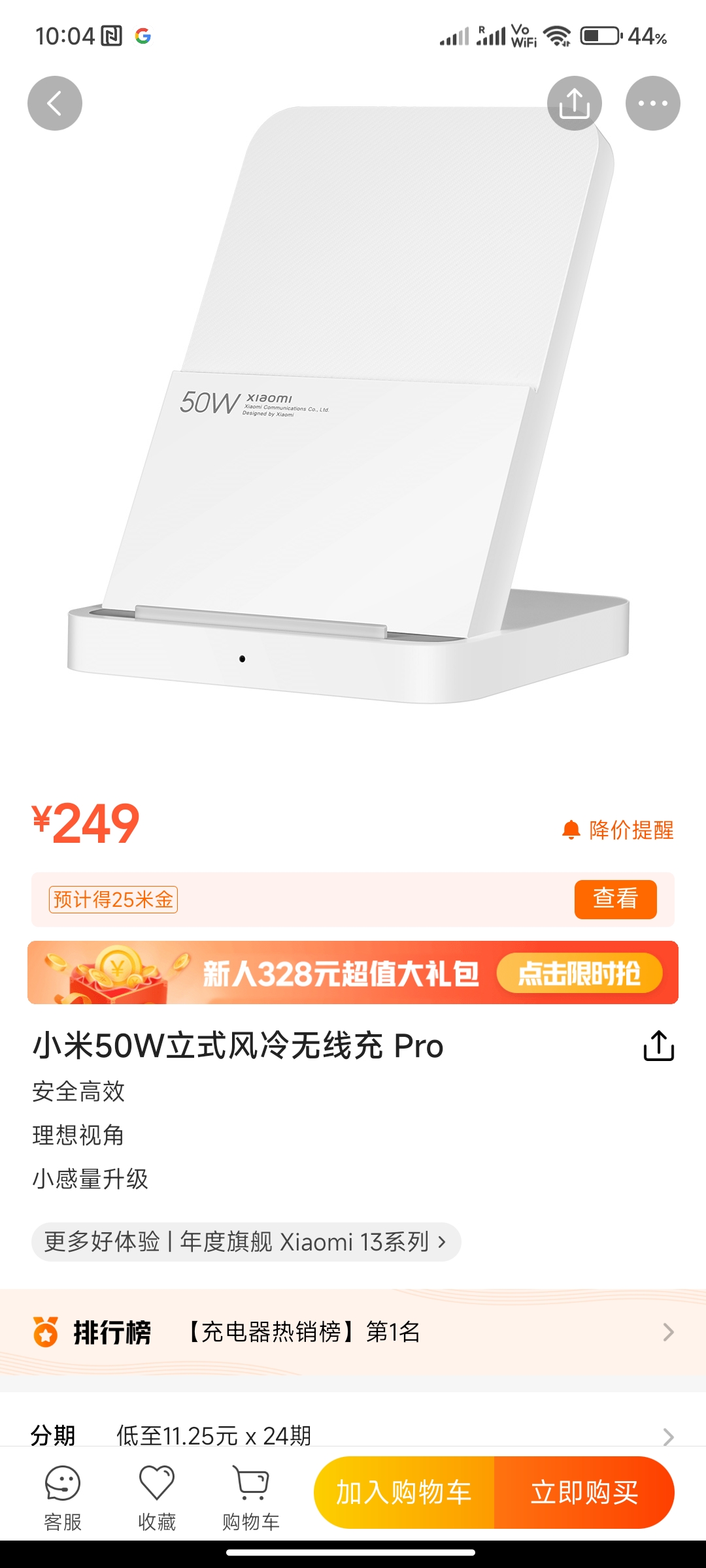

50w wireless is only with the wireless charger Xiaomi provides(new one), they changed the coil position.

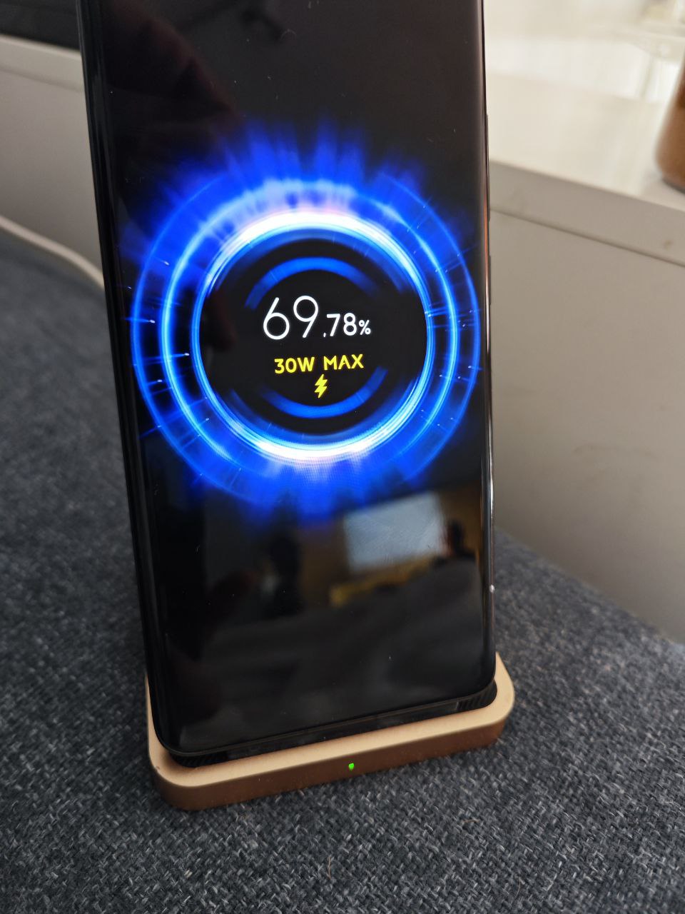

Xiaomi support told me that since I bought it recently I requested a replacement and now... they haven't told me anything else...

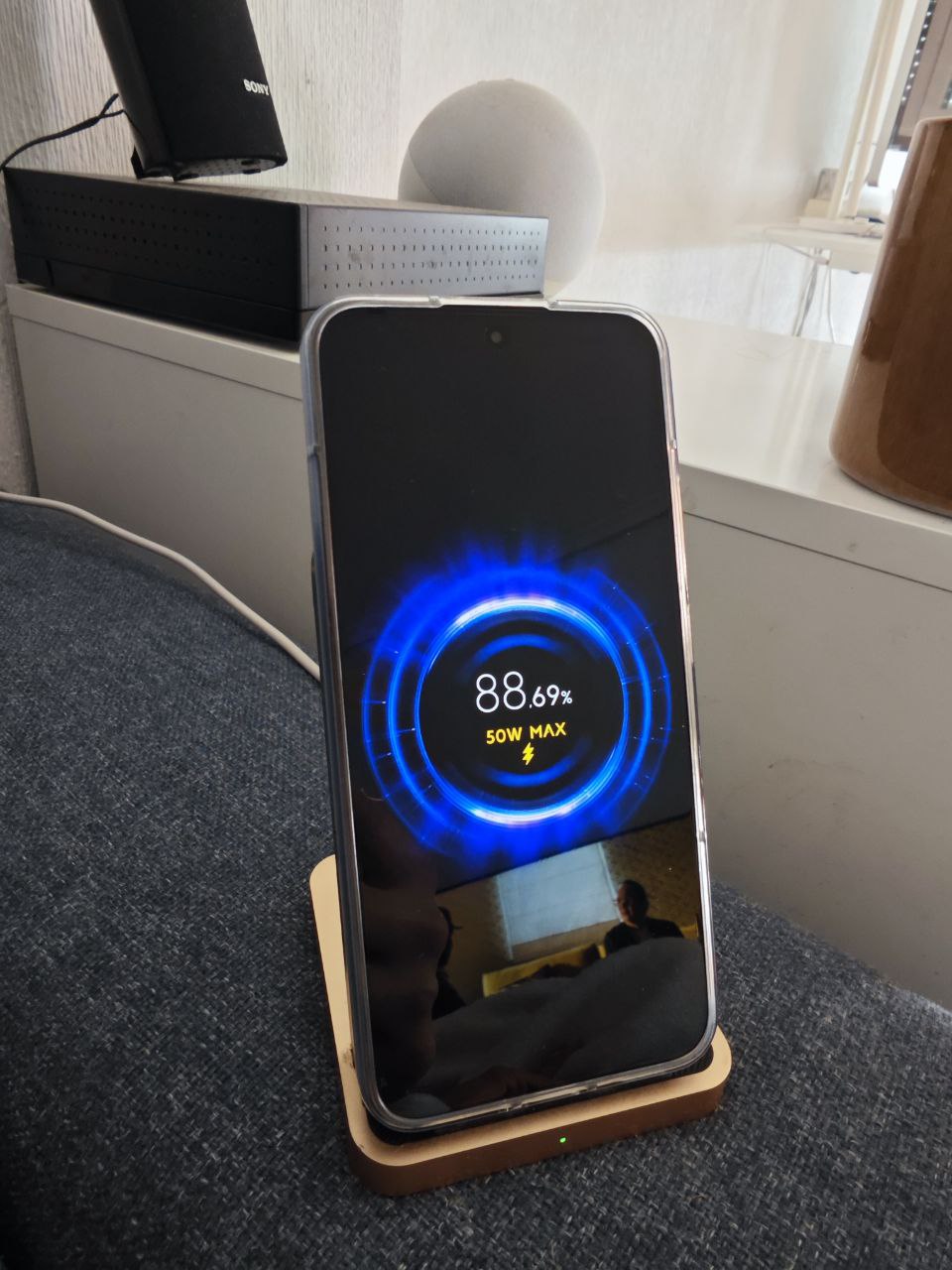

Xiaomi 13 work 50W and 13 Pro max 30W
So.. I fixed it for the desktop chargers. U gotta plug in xiaomi original 120w charger to it not third party gan charger. However one of my third party gan chargers also can do 50w on my wireless charger weird.
Now only left with the car.. The xiaomi 50w wireless charger pro is capped at 30w too.
U said this issue doesn't happen with xiaomi 13? So weird. Should be a firmware thing then?
The charging base comes with the original 67w xiaomi charger, even so I have tried with the 120w one but it always works maximum at 30w but with the xiaomi 13 it always works at 50w with the 120 or 67w one
