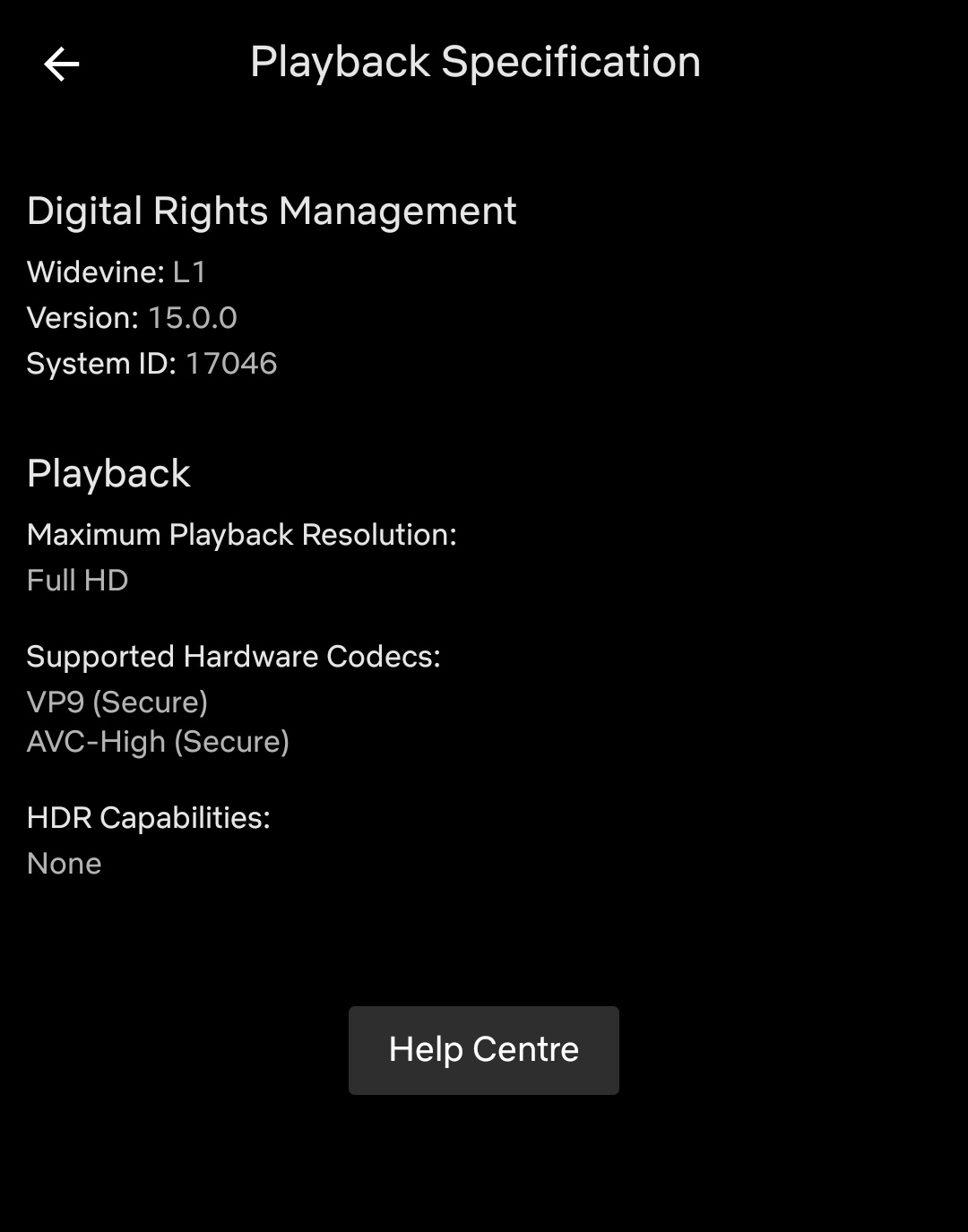

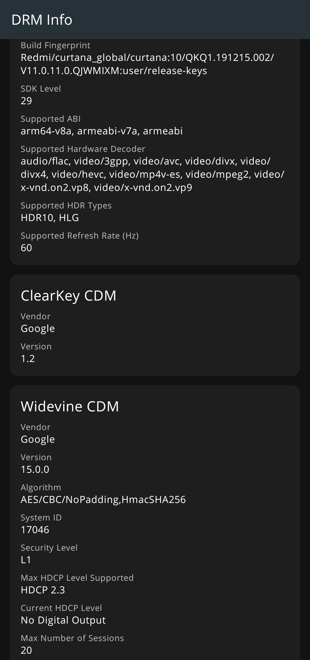

So recently I just noticed I have L1 back... After flashing a bunch of MIUI 12 Port ROMs, I decided to flash back the latest Xiaomi.eu build... I installed Netflix as usual expecting L3.. Was surprised when I saw L1... Apparently my L1 is back.. Been back since like two weeks that I flashed back Xiaomi.eu.. Was waiting to see if it would disappear again, but still here :)
Reactions: t_adams
What phone do you have? Redmi Note 9 Pro ( Joueuse )? What kind of MIUI 12 port did you install exactly? Send a link, I'll try.
