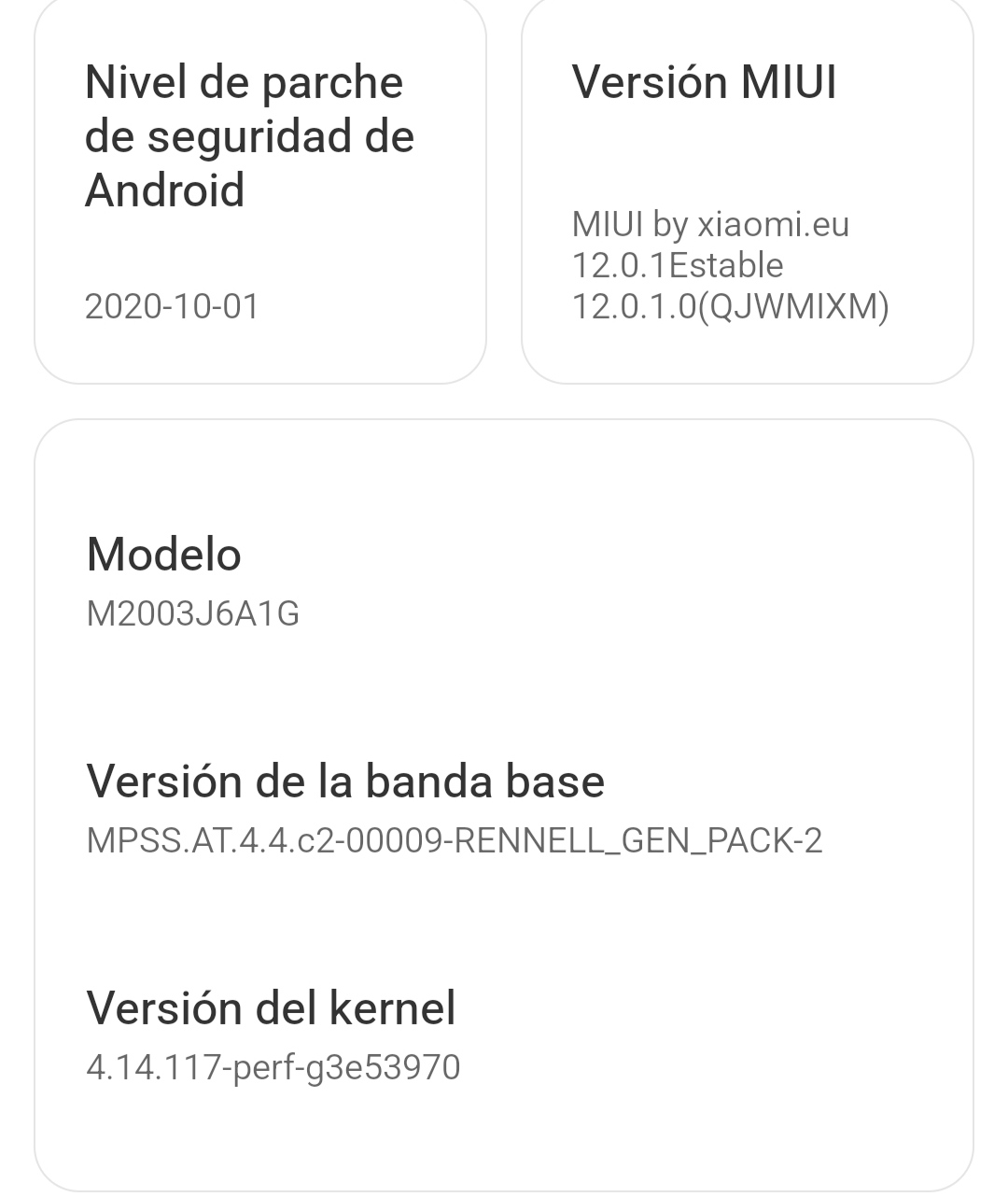

Greetings colleagues, I would like to show you the Note 9S model that I have and what I have installed, and if someone can tell me if there is any newer ROM, and that it is stable, I would appreciate it. I remember that this version that I have, they had recommended it to me because it was quite stable, but, logically, I like to be updated. I have seen that the MIUI12.5, in the versions that exist in this forum, there is not for our mobile, it would be nice to be able to update it to that latest version, but of course, if it is not prepared, better wait, right?
Well I put some screenshots of the characteristics of my phone, thanks

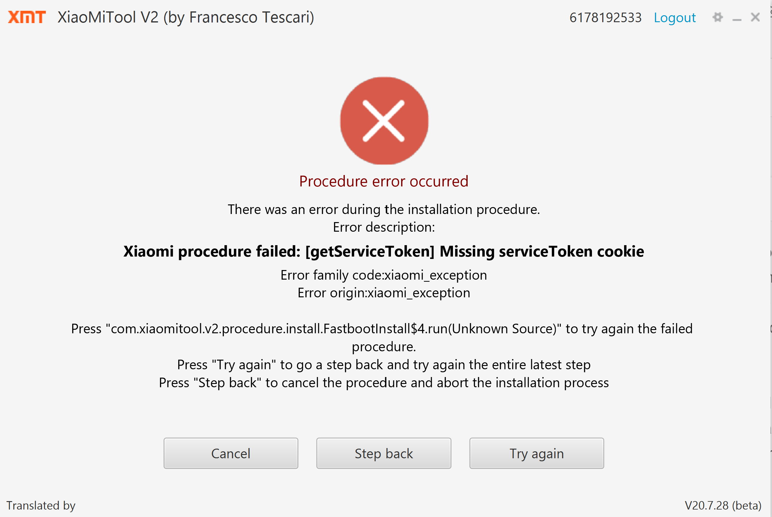

now I have a serious problem, as none of the roms were installed for me, I have put the official one from fatboot ... and I want to put the recovery orange fox, and I have seen that the bootloader has been blocked ... and if I try to unlock it , the mitool v2 tool gives me an error .....
That is, I have the official ro installed with android 11 ... but I want to change the recovery to be able to put the xiaomi eu ... but when I follow the steps with the XiaomiTool, there comes a time that gives me an error:
If you have original ROM in the phone use ofiginal Xiaomi unlock tool - https://en.miui.com/unlock/
