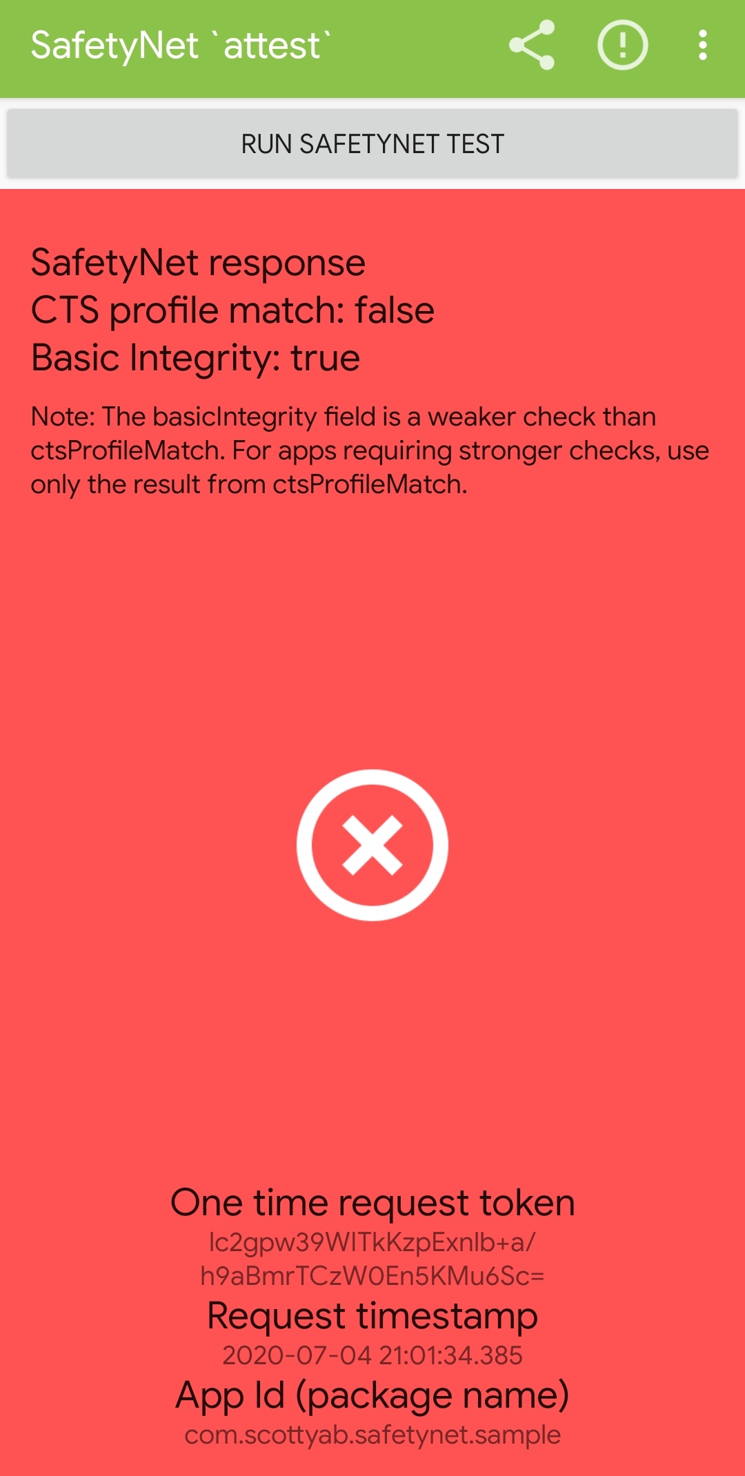

SafetyNet:
Basic Integrity true
CTS profile match false
This is because of unlocked bootloader.
Check with "SafetyNet helper sample" from Playstore on your device
You can try to hide with Magisc, but this will not work forever

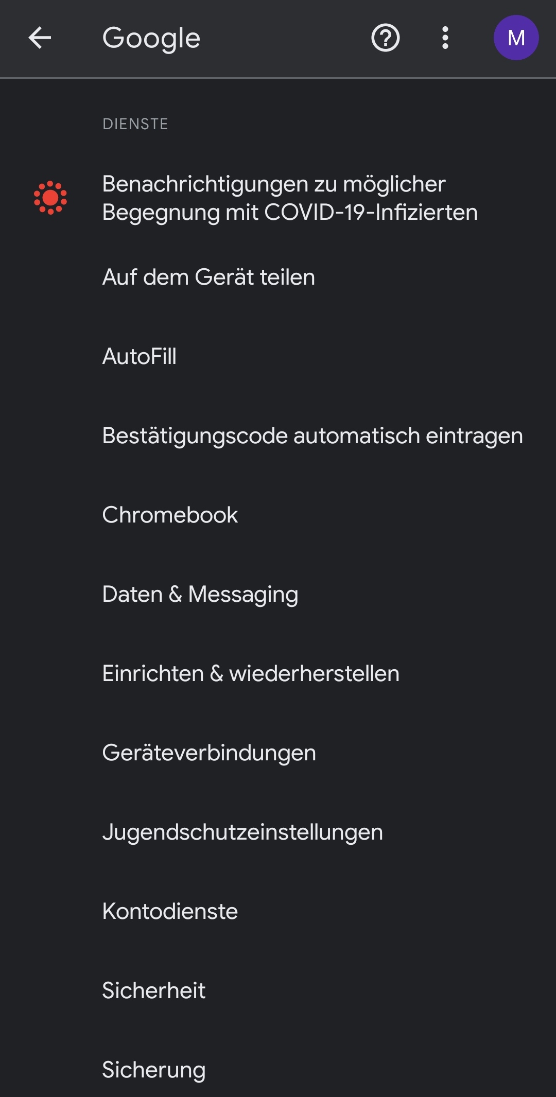

SafetNet ist rolled out via Google Services, like this new Covid stuff. Big brother has control over your device.

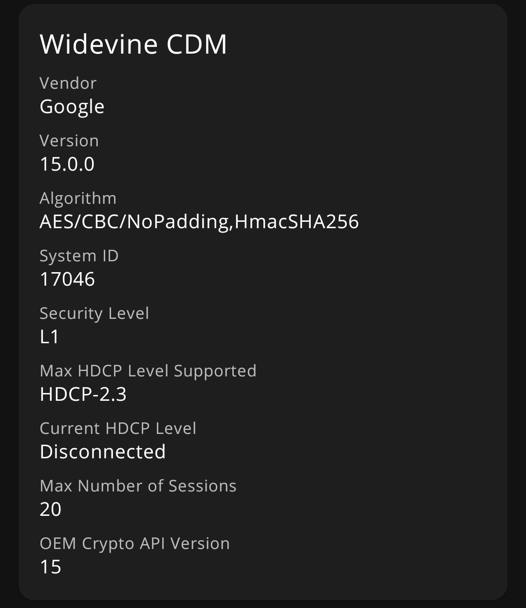

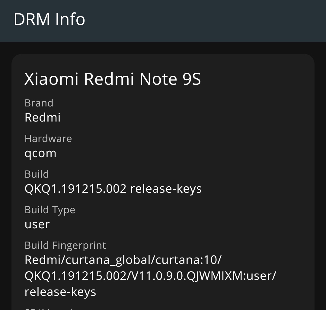

Today I run DRM info I realized that I lost my widewine L1. I specifically checked it after installing the Xiaomi.eu ROM 11.0.4.0, it was still L1. I cannot find out what has triggered it to change to L3.
