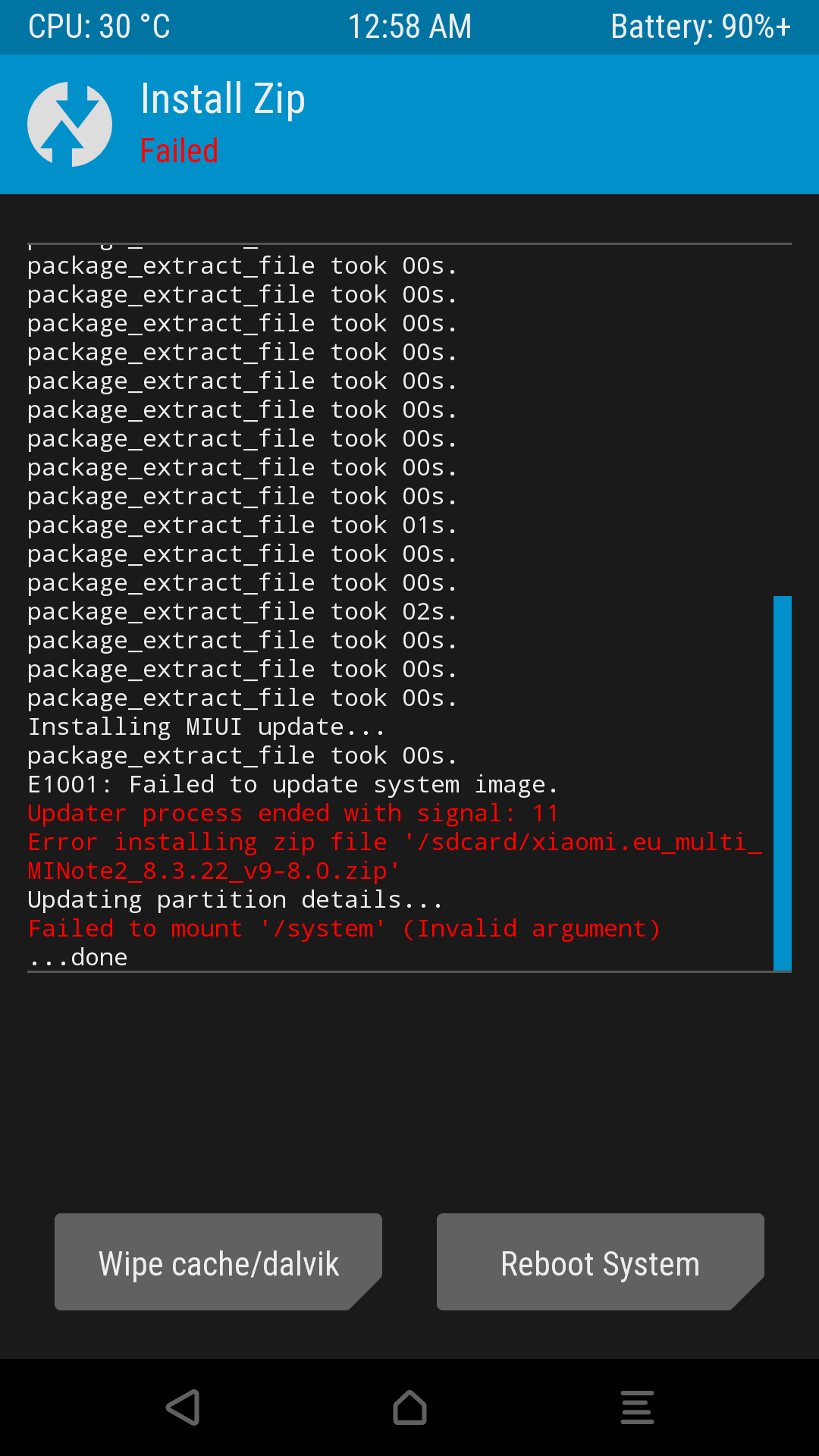

I have wird problem.
I try all version of TWRP without results to boot new custom ROM.
All of them give me errors .
Error 7 ,11 or failed to mount /system ( invalid argument)
Make a full fastboot flash with the latest china dev rom, fastboot twrp and then try again.
Can you suggest me wich TWRP to use ??
Need to lock again and flash all with mi flash?
I m crazy, try all of them.
Link please
Link please
Not , you don't need to lock your BL again. You can use the official twrp, doesn't really matter...
Some more info please...what device are you trying to install TWRP .. what ROM do you have currently...what ROM did you have before trying to flash TWRP ? ....
Device is Mi note 2 (scorpio) 6/128 GB
First rom was global 8.5... after I update do DEV .
Now was before flashing TWRP China DEV 8.3.26
How long its take in TWRP when installing MIUI update..... ?
Sometimes give me error 7 or 11
Now its pass more than 10 minutes like first picture
