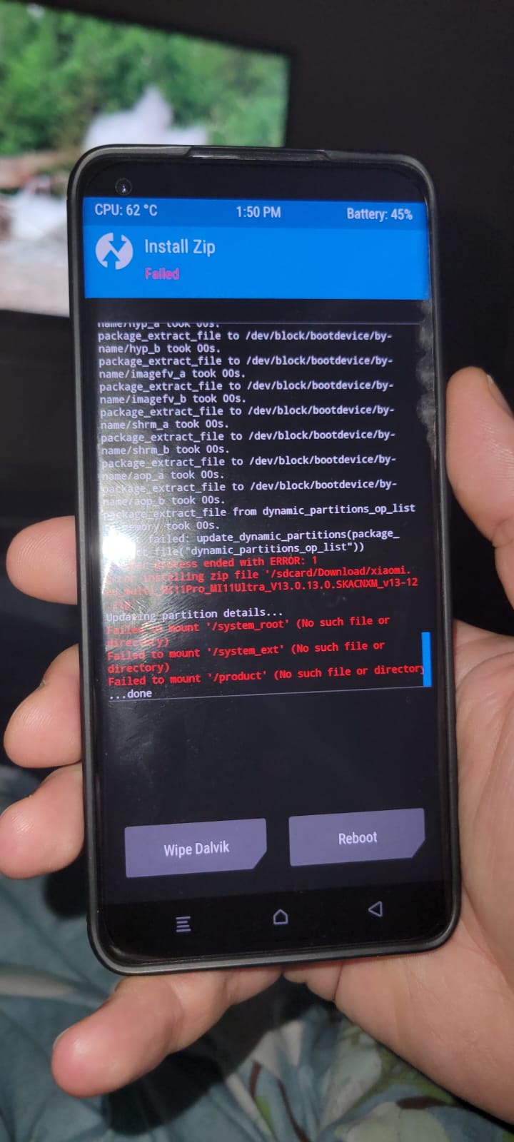

Apologies first time TRWP user here can you clarify which option is best for the Mi 11 ultra on Xiaomi EU Rom do I flash current TWRP, Onekey injection or Recovery ramdisk? Which one is best once TWRP has booted up for the first time. Thanks.
